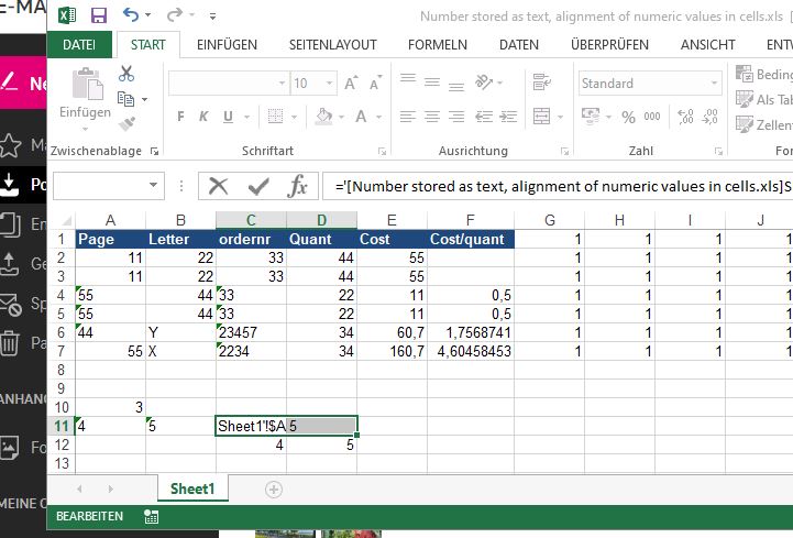

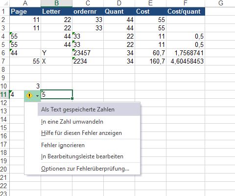

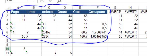

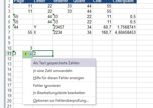

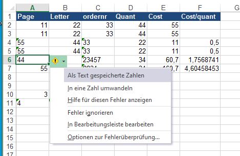

    Number stored as text, alignment of numeric values in cells
    This problem/feature pops up from time to time.
    https://i.postimg.cc/GpwT3Mzj/Number-stored-as-text.jpg
    I have seen it so far in these sort of places/ things, such as text box contents are strings by definition , …VBA enters text that is inherent to a TextBox. Every 'number' in a textBox is a string "1234". VBA has to convert those strings into long/integer, etc….
    , and when pasting things out,
    https://www.eileenslounge.com/viewto...269105#p269105 https://eileenslounge.com/viewtopic....272704#p272704
    , but it’s not always consistent, - in the next example the 3 seems to go in as a number, but the 4 and 5 go in as …" Number stored as text"
    https://i.postimg.cc/cCzwRfG1/Number...onsistancy.jpg
    '   https://www.excelfox.com/forum/showthread.php/2909-Appendix-Thread-Evaluate-Range-(-Codes-for-other-Threads-HTML-Tables-etc-)?p=21923&viewfull=1#post21923
    Sub Number_stored_as_text__alignment_of_numeric_values_in_cells()   '      https://i.postimg.cc/cCzwRfG1/Number-stored-as-text-inconsistancy.jpg
    Dim Ex As String
     Let Ex = "3"
     Let ActiveSheet.Range("A10").Value = Ex ' Puts in as number
    Dim Exs(1 To 2) As String: Let Exs(1) = "4": Exs(2) = "5"
     Let ActiveSheet.Range("A11:B11").Value = Exs()

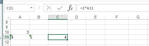

    Take the screenshot example from the last post. In C11 this appears to work, =1*A11
    _____ Workbook: Number stored as text, alignment of numeric values in cells.xls ( Using Excel 2013 32 bit )
    Row\Col A B C
    10 3
    11 4 5 =1*A11
    12
    Worksheet: Sheet1
    https://i.postimg.cc/prJFZt2s/1xA11.jpg
    What that simple formula appears to do is to make the 4 in cell A11 be written in cell C11 a true number, and so we effectively get rid of that warning of the form , "Number stored as Text"

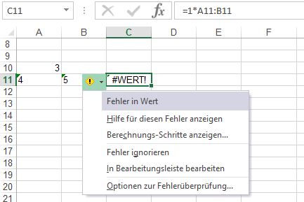

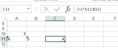

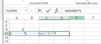

    For example, in C11, write =1*A11:B11 instead, so as to maybe see if we can somehow do our basic formula for cells A11 and B11 at the same time.
    But, try that and it will error**. Never mind. Let’s keep experimenting.
    https://i.postimg.cc/k5CmNLgp/1x-A11-B11.jpg
    https://i.postimg.cc/zBXY6WWw/1xA11B11.jpg
    (** For Excel 365 it may not error, and I prefer not to consider yet what is happening there)

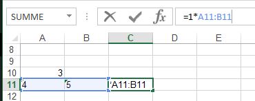

    Type 1 CSE entry
    There may be some reason such as extra overheads for Excel to show the same calculation for both cells, resulting in perhaps a deliberate prevention of the thing working, but my guess is that it does work without too much effort. Often we talk about Type 1 CSE entry, or CSE entry in general, as a way to tell Excel that you would like to take advantage of the possibility to do the calculation for a range other than a single cell.
    To get the first inclination about what I am talking about, do this: do the same thing again, in C11, write =1*A11:B11 , but don’t hit Enter yet. Instead, hold keys Ctrl+Shift and then hit Enter
    We don’t error anymore. But we still only see one value. https://i.postimg.cc/m2v5xMCx/1x-A11-B11-CSE1.jpg
    If you apply a bit of lateral thinning to what we said earlier about how computer things work , ( ……chucking out from left to right , returning to the left and gong to a new line/row, then starting again ) , a good guess might be that in our example the other calculated value might be somewhere close to the right. That takes us nicely on to the next section, and how that relates to our example

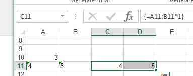

    Type 2 CSE entry
    CSE generally seems to tell Excel to do multiple cell calculations, at least that is what we suggested. (We talk sometimes about "array calculations", but this may be strictly in mathematical definitions a bit incorrect)
    But we generally write things in a cell, and generally for simple formulas we would expect a result in a cell.
    But let's try it a bit differently, bearing in mind our example. So, start again, but before you type =1*A11:B11, first select the two cells, C11 and D11. Then after you type that, do the CSE entry again, not a simple Enter
    https://i.postimg.cc/m2w2rQN9/1x-A11-B11-CSE2.jpg
    Bingo!

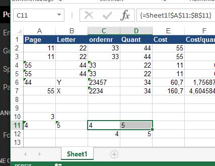

    https://i.postimg.cc/m2RgRdMR/1x-A11-B11-CSE2-Bingo.jpg

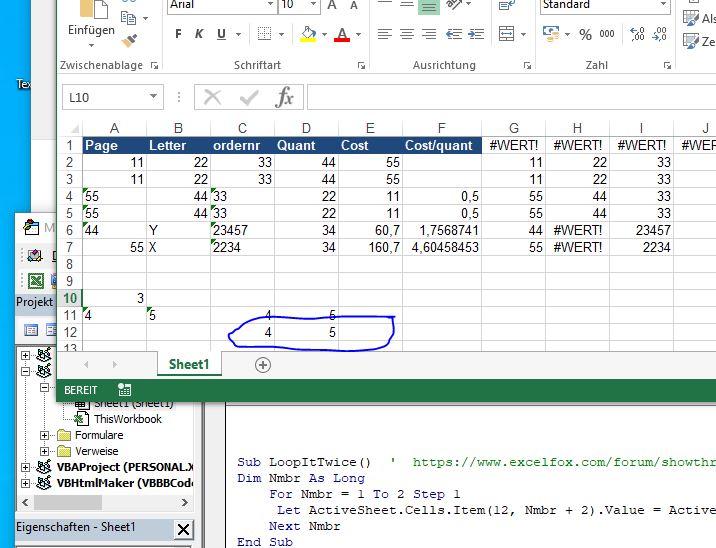

    In VBA, a conventional way to do multi cell calculations would be to Loop. It loops, in other words does a similar codung a few times. It would need to do it twice, https://i.postimg.cc/Wb8ZRJM7/Loop-i...mn-A-and-B.jpg , in our example:
    Sub LoopItTwice()  '  https://www.excelfox.com/forum/showthread.php/2909-Appendix-Thread-Evaluate-Range-(-Codes-for-other-Threads-HTML-Tables-etc-)?p=21924&viewfull=1#post21924
    Dim Nmbr As Long
        For Nmbr = 1 To 2 Step 1
         Let ActiveSheet.Cells.Item(12, Nmbr + 2).Value = ActiveSheet.Cells.Item(11, Nmbr).Value  '    Always uses row 12 ,   done twice, first  for  column 3 value = column 1 value    and  then   column 4 value = column 2
        Next Nmbr

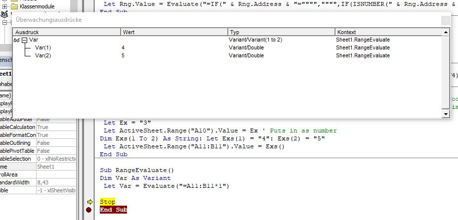

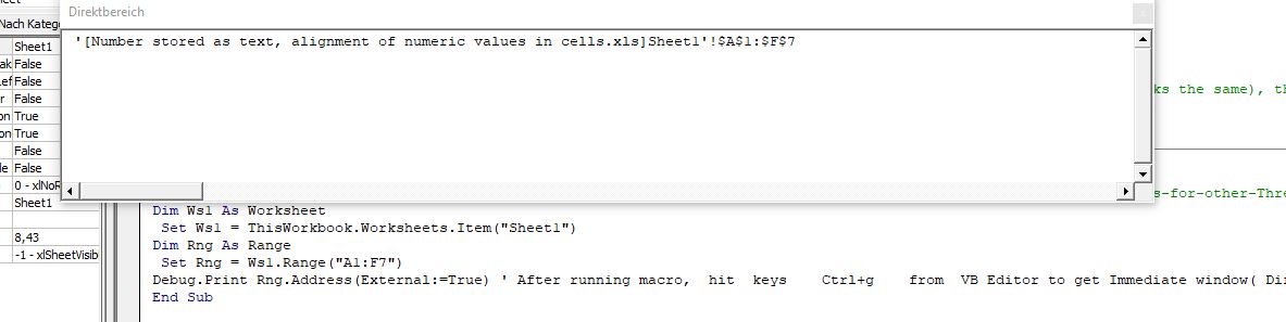

    If you put a Stop statement (or alternatively click in the left margin to get a brown circle which works the same), then run the following full macro, then while it is paused, (or before you start) , highlight Var , hold key Shift and then hit key F9, to put a watch on that variable, then you can see the results.
    https://i.postimg.cc/vmPf13Cx/Put-a-watch-on-Var.jpg
    https://i.postimg.cc/mDtM77GX/Put-a-watch-on-Var.jpg
    Sub RangeEvaluate()
    Dim Var As Variant
     Let Var = Evaluate("=A11:B11*1")
    Stop   '     If you put a Stop statement (or alternatively click in the left margin to get a brown circle which works the same), then run the following full macro, then while it is paused, (or before you start) , highlight Var , hold key Shift  and then hit key F9, to put a watch on that variable, then you can see the results.
    'https://i.postimg.cc/vmPf13Cx/Put-a-watch-on-Var.jpg
    'https://i.postimg.cc/mDtM77GX/Put-a-watch-on-Var.jpg
    https://i.postimg.cc/9Mb931YQ/Put-a-watch-on-Var.jpg

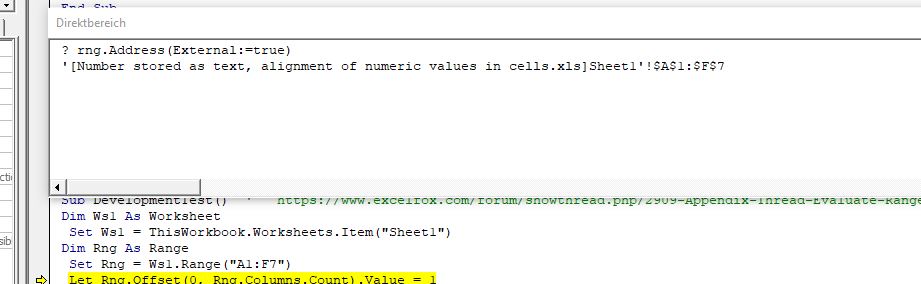

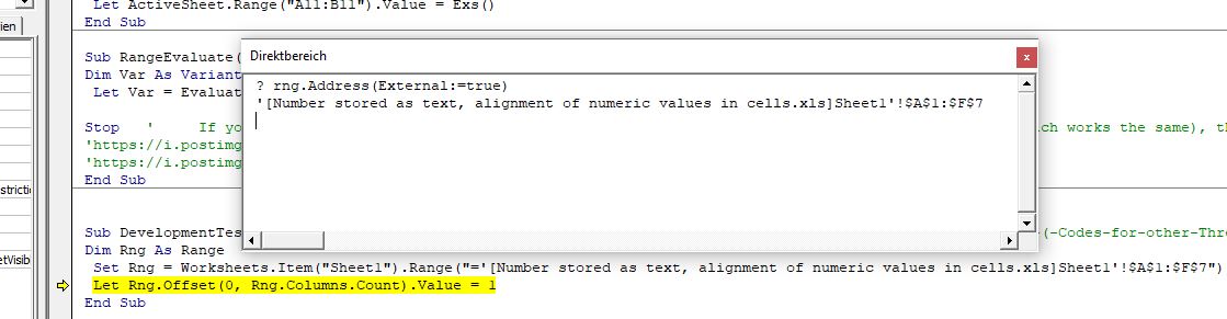

    External:= This could do with a bit of discussion:
    If we set this to True, which is not the default we are arguably doing things a bit better since we are ensuring we refer to the correct worksheet, (and the correct workbook).
    https://i.postimg.cc/TYCc8Fc4/Range-...ernal-True.jpg
    https://i.postimg.cc/zGvFq7tX/Range-...ernal-True.jpg
    https://i.postimg.cc/jS1Q2fm6/Range-...ernal-True.jpg
    https://i.postimg.cc/LXmjVN2z/Range-...ate-Window.jpg

    Debug.Print Rng.Address '  gives im Immediate Window        $A$1:$F$7      ( After running macro,  hit  keys    Ctrl+g    from  VB Editor to get Immediate window( Direktbereich in German), in which this code line should have put the value of    Rng.Address(External:=True)      something like this sort of form      '[Number stored as text, alignment of numeric values in cells.xls]Sheet1'!$A$1:$F$7
    Debug.Print Rng.Address(External:=True) ' After running macro,  hit  keys    Ctrl+g    from  VB Editor to get Immediate window( Direktbereich in German), in which this code line should have put the value of    Rng.Address(External:=True)      something like this sort of form      '[Number stored as text, alignment of numeric values in cells.xls]Sheet1'!$A$1:$F$7

    This is our test data, https://i.postimg.cc/KvhPVN44/Test-Data.jpg
    https://i.postimg.cc/8PkRNCBV/Test-Data.jpg
    Row\Col A B C D E F
    1 Page Letter ordernr Quant Cost Cost/quant
    2 11 22 33 44 55
    3 11 22 33 44 55
    4 55 44 33 22 11 0,5
    5 55 44 33 22 11 0,5
    6 44 Y 23457 34 60,7 1,7568741
    7 55 X 2234 34 160,7 4,60458453
    Worksheet: Sheet1

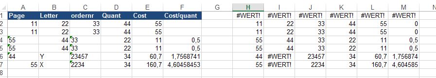

    This is the result after running the macro
    Row\Col A B C D E F G H I J K L M
    1 Page Letter ordernr Quant Cost Cost/quant #WERT! #WERT! #WERT! #WERT! #WERT! #WERT!
    2 11 22 33 44 55 11 22 33 44 55 0
    3 11 22 33 44 55 11 22 33 44 55 0
    4 55 44 33 22 11 0,5 55 44 33 22 11 0,5
    5 55 44 33 22 11 0,5 55 44 33 22 11 0,5
    6 44 Y 23457 34 60,7 1,7568741 44 #WERT! 23457 34 60,7 1,756874
    7 55 X 2234 34 160,7 4,60458453 55 #WERT! 2234 34 160,7 4,604585
    Worksheet: Sheet1
    Oh bollox, a couple of problems
    We see a couple of problems. An empty cell comes out as a 0 in the output, and text in any cell results in an error in the output.
    In the next post, we look at overcoming these two problems

    In the first cell, A1, we have a number held as text. The range object seems to know this, and we find that if we try to write that in another cell, ( Let LHS = ) then we don’t get an error, but rather the text is put in. This is a strange thing, and its discussed in more detail somewhere else, ( Post is #21995 Page2 #12 https://www.excelfox.com/forum/showt...age2#Post21995 ) , but important for our considerations here is that it is a range object phenomena, so in '1b) we compare what happens for the RHS of Range(" ") or Evaluate(" ").
    The result is the same.
    In fact, not known to many people, some Excel functions also return range objects, ( https://eileenslounge.com/viewtopic....280942#p280942
    https://www.myonlinetraininghub.com/...#comment-84892 February 20, 2021 at 3:18 am
    ). and we find that the behaviour in what happens for the RHS of Range(" ") or Evaluate(" ") is consistent for this as well, it’s the same again
     '1b) Something Else    https://www.youtube.com/watch?v=Td3r55oyiu0
    Ws.Range("A2").Clear
     Let Ws.Range("A2") = Ws.Range("=IF(1,A1)")    ' Watch : + : Ws.Range("=IF(1,A1)") : "44" : Object/Range : Tabelle6.RangeEvaluate
     Let Ws.Range("A2") = Ws.Evaluate("=IF(1,A1)") ' Watch : + :  Ws.Evaluate("=IF(1,A1)") : "44" : Variant/Object/Range : Tabelle6.RangeEvaluate

    What’s all this got to do with my Evaluate range one liner answer here: https://eileenslounge.com/viewtopic....309137#p309137
    Well, I was trying to get a number held as text to change to a number, (to get rid of the little warning and the alignment difference to that for a number). My solution was based on pseudo code of CellValue x 1, as this is a typical way in Excel, or computing generally, to get a text that looks like a number to become a true number.
    It worked.
    But then when I looked at this in more detail, I thought it shouldn’t
