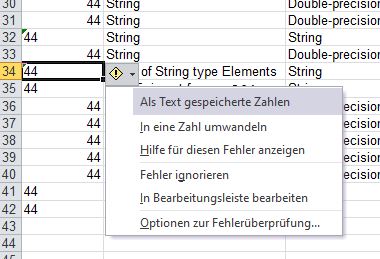

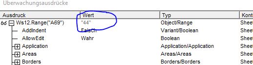

    In that last screen shot, for cell C69, where we have a number, showing as a number , we see 44
    In this next screenshot, for cell A69, where we have a number but the cell is displaying the Number stored as text Thing , we see there " 44 "
    https://i.postimg.cc/Xq1HsdJL/Cell-A69.jpg
    This might be the "thing" that we sometimes get for various objects, when we assign that object to a string type variable. For some reason it works then differently, rather than "writing" into the cell in similar way that we might do, it does it in some other way such that the actual text is put in, and so we appear to get the Number stored as text Thing warning thing preserved.

     Set Rng = Ws12.Range("A69")      '  Watch : + : Rng : "44" : Range/Range : Sheet2.RangeObjectDefaultPropertiesCells
    Debug.Print VarTyp(VarType(Rng))  '  String  What is this String? Could it be this  https://i.postimg.cc/0NWjBNHB/Number-stored-as-Text-Thing-Could-it-be-this.jpg ,   the "written property value"  https://i.postimg.cc/ryGZ6jb6/Written-Property-Value.jpg
    Dim vTemp As Variant, Str As String
     Let vTemp = Rng '                   Watch :   : vTemp : "44" : Variant/String : Sheet2.RangeObjectDefaultPropertiesCells
     Let Str = Rng  '                    Watch :   : Str : "44" : String : Sheet2.RangeObjectDefaultPropertiesCells

     Let Ws12.Range("C75") = Rng  ' this DOES the   Number stored as Text Thing   https://i.postimg.cc/hvzKQyxb/Number-held-as-string-thing.jpg   https://i.postimg.cc/XYrvmWdH/Number-stored-as-Text-Thing.jpg    Number held as text thing
    ' If you don't use  .Value   a range object is put in, something we human's can't do , and any  Number as text stuff   will be preserved
    '    ' Or
    '  This might be the "thing" that we sometimes get for various objects, when we assign that object to a string type variable. For some reason it works then differently, rather than "writing" into the cell in similar way that we might do, it does it in some other way such that the actual text is put in, and so we appear to get the Number stored as text Thing warning thing preserved
    '  https://i.postimg.cc/Xq1HsdJL/Cell-A69.jpg

    What happens in the case of no .Value is, well, nothing, at least nothing we can see. Strange. Or maybe not: If we compare a similar Watch Window view, to that for the single cell case,
    , for example of a two cell range, A69:B69, we see an empty space

     Ws12.Range("A80:D80").Clear  '  .Clear  to get rid of all valiues and any formats
     Ws12.Range("A69:B69").Clear
     Let Ws12.Range("A69").Value = Split("44") ' '         Gives  Number held as text thing
     Let Ws12.Range("B69").Value = "42"    '      does not gives                            "
    Dim Rng As Range
     Set Rng = Ws12.Range("A69:B69")      '  Watch : + : Rng :  : Range/Range : Sheet2.RangeObjectsDefaultPropertiesCells
    '                                               + : Value2 :  : Variant/Variant(1 to 1, 1 to 2) : Sheet2.RangeObjectsDefaultPropertiesCells
    '                                                       + : Value2(1) :  : Variant(1 to 2) : Sheet2.RangeObjectsDefaultPropertiesCells
    '                                                                       : Value2(1,1) : "44" : Variant/String : Sheet2.RangeObjectsDefaultPropertiesCells
    '                                                                       : Value2(1,2) : 42 : Variant/Double : Sheet2.RangeObjectsDefaultPropertiesCells
    Debug.Print VarTyp(VarType(Rng))  '  Array of Variant type Elements
     Let vTemp = Rng '                       Watch : + : vTemp :  : Variant/Variant(1 to 1, 1 to 2) : Sheet2.RangeObjectsDefaultPropertiesCells
    '                                             + : vTemp(1) :  : Variant(1 to 2) : Sheet2.RangeObjectsDefaultPropertiesCells
    '                                                      : vTemp(1,1) : "44" : Variant/String : Sheet2.RangeObjectsDefaultPropertiesCells
    '                                                      : vTemp(1,2) : 42 : Variant/Double : Sheet2.RangeObjectsDefaultPropertiesCells

    ' Note that we see an empty space here :     https://i.postimg.cc/sgdHWZc7/Range-A69-B69.jpg                 https://i.postimg.cc/sgdHWZc7/Range-A69-B69.jpg
