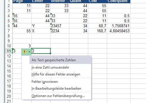

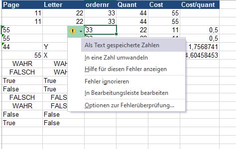

    My answer in that Thread was an attempt to get rid of that Number stored as Text warning thing, https://i.postimg.cc/X7hZDNDg/Number-stored-as-text.jpg
    https://i.postimg.cc/5NjY3Qp0/Number-stored-as-text.jpg

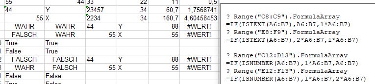

    In the second worksheet in the uploaded file we have the main test data range from Chris, but to simplify this post I will just use a small section, A6:B7 , and do some simple Excel formulas initially involving ISTEXT and ISNUMBER
    Initially results are as expected, or at least in a variation of one of the possibilities that we might have expected: The problem cell, A6, is seen as TEXT or not as a NUMBER

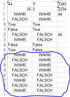

    https://i.postimg.cc/6psVSh8q/ISTEXT...-initially.jpg
    The next set of results however show a slight anomaly. It would appear that in the larger formula pairs, the one of the pair which would effectively be doing just =A6 makes some change, bit only half way: The warning thing is gone, but the alignment has not changed ( The formula in the pair contain the *2 , I just did to check what of the two options after the IF was being selected. The results there confirm that the involving ISTEXT and ISNUMBER is behaving inside the n as it did on its own )
    https://i.postimg.cc/7YJMmRYj/ISTEXT...iour-in-IF.jpg

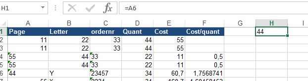

    In fact a simple cell reference exhibits a similar behaviour https://i.postimg.cc/3Nf7LBYx/A6.jpg
    So a simple reference seems to be doing something strange, maybe getting sort of half way there.
    Before going any further, we should perhaps try the same experiments in Evaluate(" ") , since things do not always work exactly the same in worksheet cells and in Evaluate(" ") : There are sometimes minor differences.
    How does the function formulas behave in Evaluate(" ")
    The spreadsheet looks similar, (the small difference is explained by VBA working in English, recognising the text I used as a Boolean at some point, possibly, perhaps at point of insertion, which my German Excel then displays in the appropriate German syntax word)
    https://i.postimg.cc/26JkxYYK/Evalua...preadsheet.jpg

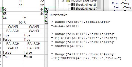

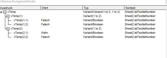

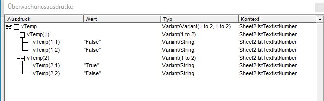

    The Watch Window from coding is also not showing any surprises from Evaluate(" ") yet
    I mean the Evaluate(" ") has not shown any great surprises yet.
    Sub IstTextIstNumber() '  https://www.excelfox.com/forum/showthread.php/2345-Appendix-Thread-(-Codes-for-other-Threads-HTML-Tables-etc-)?p=21970&viewfull=1#post21970
    Dim Ws12 As Worksheet: Set Ws12 = ThisWorkbook.Worksheets.Item("Sheet1 (2)")
    Dim Rng As Range: Set Rng = Ws12.Range("A6:B7")
    Dim vTemp As Variant
     Let vTemp = Evaluate("=IF({1},ISTEXT(A6:B7))") '
     Let Ws12.Range("A16:B17").Value = vTemp
     Let Ws12.Range("A16:B17").Value = Evaluate("=IF({1},ISTEXT(A6:B7))")
     Let vTemp = Evaluate("=IF(ISTEXT(A6:B7),""True"",""False"")") '
     Let Ws12.Range("A18:B19").Value = vTemp
     Let Ws12.Range("A18:B19").Value = Evaluate("=IF(ISTEXT(A6:B7),""True"",""False"")")
     Let vTemp = Evaluate("=IF({1},ISNUMBER(A6:B7))") '
     Let Ws12.Range("A20:B21").Value = vTemp
     Let Ws12.Range("A20:B21").Value = Evaluate("=IF({1},ISNUMBER(A6:B7))")
     Let vTemp = Evaluate("=IF(ISNUMBER(A6:B7),""True"",""False"")") '
     Let Ws12.Range("A22:B23").Value = vTemp
     Let Ws12.Range("A22:B23").Value = Evaluate("=IF(ISNUMBER(A6:B7),""True"",""False"")")

    Now, in a spare range, C12:D13, in the spreadsheet I did this CSE type 2 thing {=IF(ISNUMBER(A6:B7),1*A6:B7,A6:B7)}, and got this https://i.postimg.cc/PfWKPgtj/ISNUMB...iour-in-IF.jpg
    It appeared that we got the 1* done on the 55, but not on the 44, which was also thought a possibility, so making the ISNUMBERless useful to recognise that 44 as a number. But we noted it went half way, it’s doing half the job, sort of. We further noted that this rather means that the simple = A6 is doing half the job, sort of. This half the job, that is to say the half not yet finished, is something going on in the spreadsheet. Maybe that tells us what is going to happen next

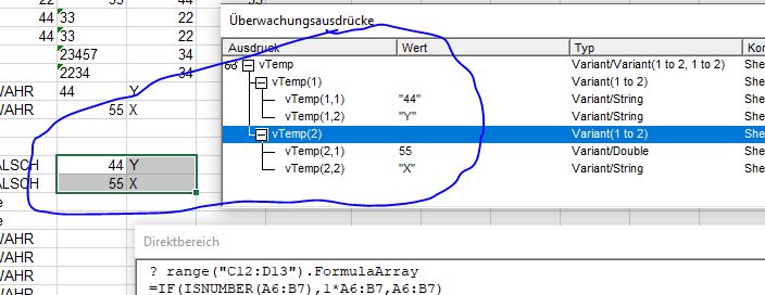

    It appeared that we got the 1* done on the 55, but not on the 44, which was also thought a possibility, so making the ISNUMBER less useful to recognise that 44 as a number. But we noted it went half way, it’s doing half the job, sort of. We further noted that this rather means that the simple = A6 is doing half the job, sort of. This half the job, that is to say the half not yet finished, is something going on in the spreadsheet. Maybe that tells us what is going to happen next
    So here we go:
    '_________________
    '_________________
    ' THE MORE PRACTICAL USE.....  IT APPEARED THAT WE GOT THE 1* DONE ON THE 55, BUT NOT ON THE 44, WHICH WAS ALSO THOUGHT A POSSIBILITY, SO MAKING THE ISNUMBERLESS USEFUL TO RECOGNISE THAT 44 AS A NUMBER. BUT WE NOTED IT WENT HALF WAY, IT’S DOING HALF THE JOB, SORT OF. WE FURTHER NOTED THAT THIS RATHER MEANS THAT THE SIMPLE = A6 IS DOING HALF THE JOB, SORT OF. THIS HALF THE JOB, THAT IS TO SAY THE HALF NOT YET FINISHED, IS SOMETHING GOING ON IN THE SPREADSHEET. MAYBE THAT TELLS US WHAT IS GOING TO HAPPEN NEXT
    DIM STREVAL AS STRING
     LET STREVAL = "=IF(ISNUMBER(A6:B7),1*A6:B7,A6:B7)"
     LET VTEMP = EVALUATE("" & STREVAL & "")  '  Attachment 5121
     LET RANGE("C12:D13").VALUE = VTEMP
    '   AHH, ITS WORKING SOMEHOW UNEXPECTIDLY  IN EVALUATE ( IF(ISNUMBER(  ),  ,)  THEN PUT THAT IN CELL
    Strange , it works fully.
    , and a quick check with strEval = "=IF(ISNUMBER(A6:B7),1*A6:B7,2*A6:B7)" confirms we are selecting the “ else ” part from the IF( , , else ) for the 44

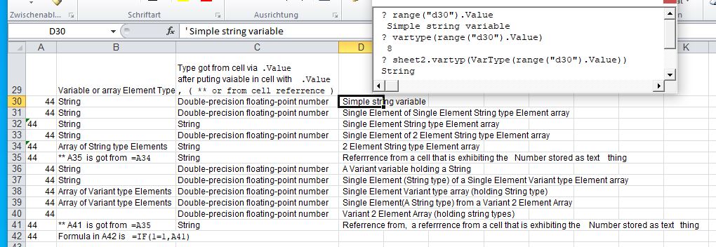

    Text strings in and out of spreadsheet and effect on Text held as number thing
    The following macro in conjunction with the spreadsheet range, in this post in picture, (in the next post in more detail), experiments with putting the value of 44 in a spreadsheet in different ways, mostly as a string, and makes some attempt to see how the thing is then seen.
    It is a bit too boring to explain every code line and everything in great detail. If and when you have the time then best go through the macro in the VB Editor in step F8 debug mode and follow through the various 'comments as you go along.
    I will just give my conclusions at the end of the next post
    '  https://www.excelfox.com/forum/showthread.php/2345-Appendix-Thread-(-Codes-for-other-Threads-HTML-Tables-etc-)?p=21975&viewfull=1#post21975
    Sub Putting44HeldAsStringTypeInSpreadsheet_ThatStringIsInVariousVariablesAndArrays() ' https://www.excelfox.com/forum/showthread.php/2345-Appendix-Thread-(-Codes-for-other-Threads-HTML-Tables-etc-)?p=21975&viewfull=1#post21975
         Ws12.Range("A30:C42").Clear
    30  ' Simple string variable
        Dim StrNmbr As String
         Let StrNmbr = "44": Ws12.Range("B30").Value = VarTyp(VarType(StrNmbr))
         Let Ws12.Range("A30").Value = StrNmbr: Let Ws12.Range("C30").Value = VarTyp(VarType(Ws12.Range("A30").Value))
    31  ' Single Element of Single Element String type Element array
        Dim StrNbr(1 To 1) As String
         Let StrNbr(1) = "44": Ws12.Range("B31").Value = VarTyp(VarType(StrNbr(1)))
         Let Ws12.Range("A31").Value = StrNbr(1): Let Ws12.Range("C31").Value = VarTyp(VarType(Ws12.Range("A31").Value))
    32  ' Single Element String type Element array
                               Ws12.Range("B32").Value = VarTyp(VarType(StrNbr(1)))
         Let Ws12.Range("A32").Value = StrNbr(): Let Ws12.Range("C32").Value = VarTyp(VarType(Ws12.Range("A32").Value))
    33  ' Single Element of 2 Element String type Element array
        Dim StrNbrs(1 To 2) As String
         Let StrNbrs(1) = "44": Ws12.Range("B33").Value = VarTyp(VarType(StrNbrs(1)))
         Let StrNbrs(2) = "45"
         Let Ws12.Range("A33").Value = StrNbrs(1): Let Ws12.Range("C33").Value = VarTyp(VarType(Ws12.Range("A33").Value))
    34  ' 2 Element String type Element array
                               Ws12.Range("B34").Value = VarTyp(VarType(StrNbrs()))
         Let Ws12.Range("A34").Value = StrNbrs(): Let Ws12.Range("C34").Value = VarTyp(VarType(Ws12.Range("A34").Value))
    35  ' Referrrence from a cell that is exhibiting the  Number stored as text
                                                                                                                         Let Ws12.Range("A35").Value = "=A34": Ws12.Range("B35").Value = "** A35  is got from  =A34": Ws12.Range("B35").Characters(Start:=21, Length:=5).Font.Name = "Courier New"
                                                  Let Ws12.Range("C35").Value = VarTyp(VarType(Ws12.Range("A35").Value))

  6. #96
    In the following spreadsheet range, the range A30:C41 is filled in by the macro from the last post, ( also included in the file attached to this post )
    What we are basically doing is storing the value of 44 in string format in various ways,
    _ in simple variables and also
    _ as elements in an array
    , and then we look at putting
    _ those variables,
    _ or an element in an array,
    _ or the whole array
    , into a spreadsheet using the _ Range("G45").Value = __ type of way
    https://i.postimg.cc/8z8NGnQ9/Text-s...mber-thing.jpg
    Text strings in and out of spreadsheet and effect on Text held as number thing.jpg
     _____ Workbook: Number stored as text, alignment of numeric values in cells.xls ( Using Excel 2010 32 bit )
    Row\Col A B C D
    29 Variable or array Element Type Type got from cell via .Value after puting vaiable in cell with .Value , ( ** or from cell referrence )
    30 44 String Double-precision floating-point number Simple string variable
    31 44 String Double-precision floating-point number Single Element of Single Element String type Element array
    32 44 String String Single Element String type Element array
    33 44 String Double-precision floating-point number Single Element of 2 Element String type Element array
    34 44 Array of String type Elements String 2 Element String type Element array
    35 44 ** A35 is got from =A34 String Referrrence from a cell that is exhibiting the Number stored as text thing
    36 44 String Double-precision floating-point number A Variant variable holding a String
    37 44 String Double-precision floating-point number Single Element (String type) of a Single Element Variant type Element array
    38 44 Array of Variant type Elements Double-precision floating-point number Single Element Variant type array (holding String type)
    39 44 Array of Variant type Elements Double-precision floating-point number Single Element(A String type) from a Variant 2 Element Array
    40 44 Double-precision floating-point number Variant 2 Element Array (holding string types)
    41 44 ** A41 is got from =A35 String Referrence from, a referrrence from a cell that is exhibiting the Number stored as text thing
    42 44 Formula in A42 is =IF(1=1,A41)
    Worksheet: Sheet1 (2)
    Conclusions:
    _1) If the thing we try to put in a cell via like Range("G45").Value = is a simple single value variable, there does not appear to be a way to put "44" in a cell which would result in getting that _ Number held as text thing _
    _2) If the thing we try to put in a cell via like Range("G45").Value = is an element in an array, then the situation is slightly more varied. In order to get that Number held as text thing ,
    _2)(i) the array type must be String. (It can even be an array of just one element as in the experiment example line 32)
    , but _2)(ii) It must be applied as a an array – if you apply a single specific element from the array, then you will not get that Number held as text thing
    So that is the case when we put in a cell or cells via like Range("G45").Value = , a variable or element of an array, or an array, and it seems that only an array of string type will work to get that Number held as text thing thing
    In the next post we will look at consequences from these conclusions on Evaluate Range type solutions.
