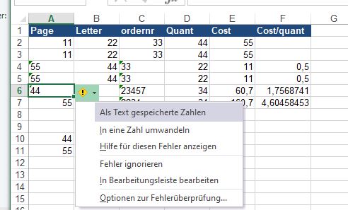

    We use the test range A6:A7 which has a number held as text and also a normal number
    https://i.postimg.cc/fLXddyGQ/A6-A7.jpg
    In the coding I have put the results of the Watch Window in the 'comments
    Now let’s analyse some of those results
    https://www.excelfox.com/forum/showt...ll=1#post23189
    https://www.excelfox.com/forum/showt...ge59#post23189
