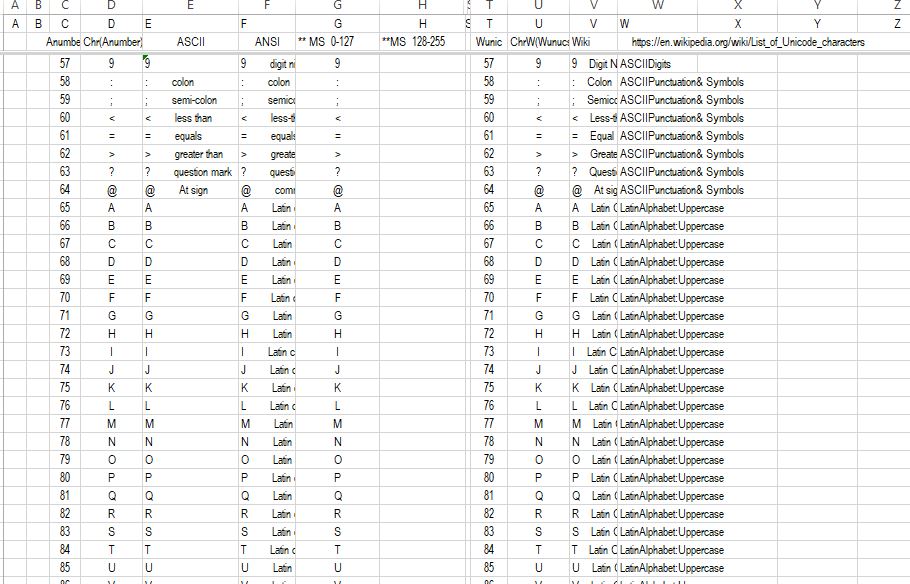

    ( It is much clearer to look at the worksheet in the uploaded file, especially as we get a lot more characters to show as we go further in the explanations, and a separate window with all of them is easier to reference when reading all this ( https://i.postimg.cc/gcKJcmY0/Table-around-127.jpg __ https://i.postimg.cc/RhGVgQPt/Table-around-255.jpg ) )
    _____ Workbook: WunucodeANSI.xlsm https://app.box.com/s/20erozqcjs2ljphkiycvbtah08y85fy9
    Row\Col C D E F G H T U V
    2 Anumber Chr(Anumber) ASCII ANSI ** MS list 0-127 ** MS list 128-255 Wunic ChrW(Wunucs) Wiki
    68 65 A A A Latin capital letter A A 65 A A Latin Capital letter A
    69 66 B B B Latin capital letter B B 66 B B Latin Capital letter B
    Worksheet: Tabelle1

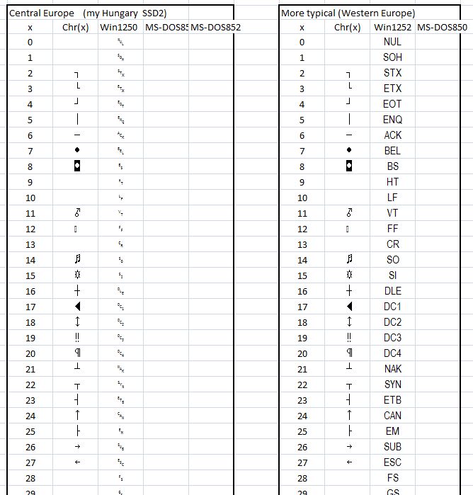

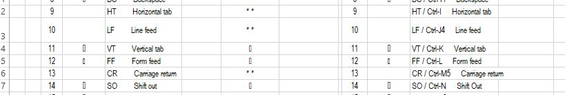

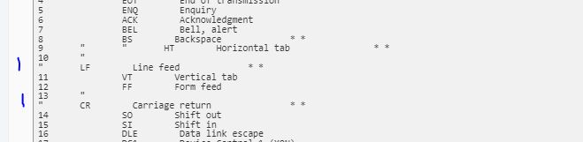

    Characters other than simple letters and numbers
    Things / like , : + $ etc etc., are perhaps easy for us to conceive as characters also.
    But there are a few others, sometimes called "invisible" characters, as they may be invisible to us, but for an ignorant computer that is itself not much more than strings of text, it needs some way to identify them things as well in any final string it has.
    These are often called control codes and are the first 31 or so in Ascii
    Depending on your personal perception of things, a space, or a new line in text may or may not be regarded as a text character. A computer language is just strings of text, so that would conveniently conceive those "invisible" things as text characters. Conventionally a simple space is given the identifying number 32, and as for a new line: in the early days of computing, a printer was often used for output, and a printer needed something in the text to cause it to move the thing making the text to go back to the left ( carriage return ) , and it also needed something to cause it to feed in/ notch up or down, for a new line ( line feed ). These have the "Ascii numbers" 10 and 13. As computers have advanced, these two characters have been kept for new lines in text, usually both are used, occasionally just either one is used instead. In VBA coding this new line identifying pair of characters will usually be recognised by
    vbCr & vbLf
    Chr(10) & Chr(13)
    Attempting to show such characters here will depend how everything involved reacts to them, as they may or may not cause a line feed of some sort. In the forum table below they are invisible, they are also invisible the spreadsheet, although in the spreadsheet the line feed seems to be showing as if two lines are present for the line feed character. In the text list in the next post they cause a bit of a mess, breaking the line into two lines at that those points
    12 9 HT Horizontal tab * * 9
    13 10 LF Line feed * * 10
    14 11 VT Vertical tab  11
    15 12 FF Form feed  12
    16 13 CR Carriage return * * 13
    17 14 SO Shift out  14
    Worksheet: Tabelle1
    https://i.postimg.cc/Y9K90SGv/Cr-and...xcel-Table.jpg
    https://i.postimg.cc/qRs73dyj/Cr-and...Text-Table.jpg

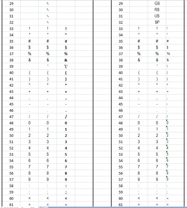

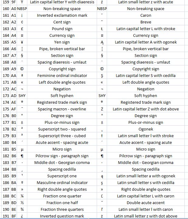

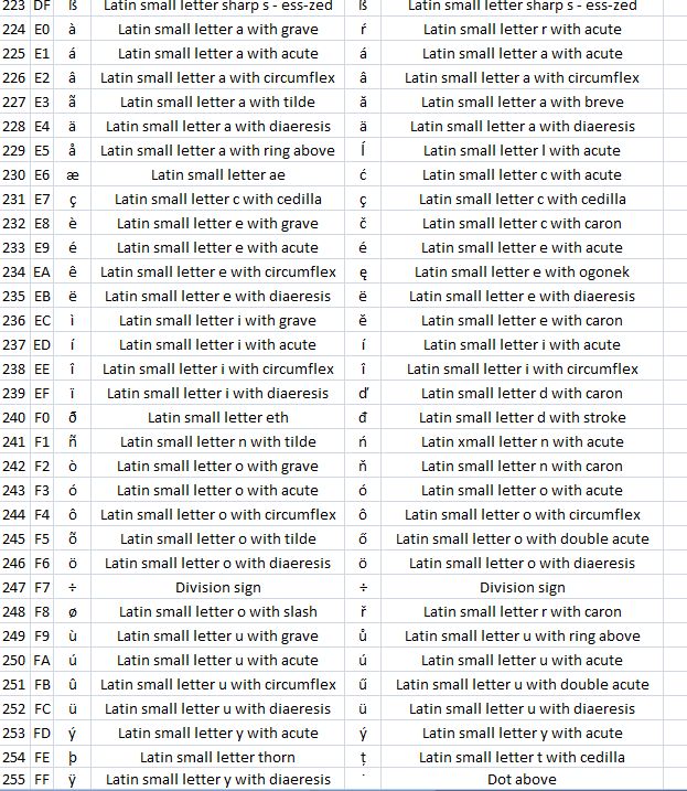

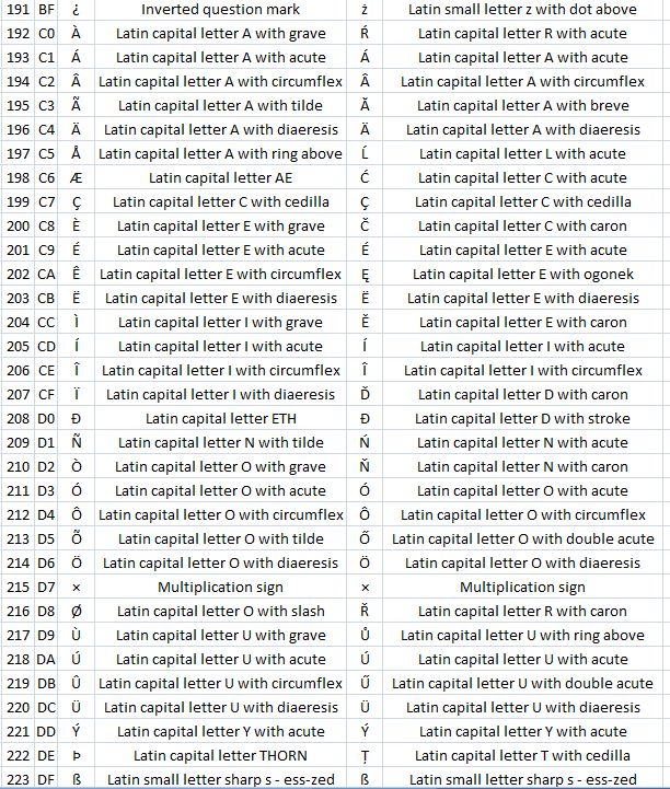

    The attempt at a large text table in the next post is an abstract from the uploaded file, only a very small part, and talking ASCII or Asc things in everyday usage, or when talking about Ascii or Ansi things in VB/ VBA, usually means talking about things in that first small part, in one way or another.

    Sub ANSIandUnicodeList()  '    , Share ‘WunucodeANSI.xlsm’ https://app.box.com/s/20erozqcjs2ljphkiycvbtah08y85fy9      https://www.excelfox.com/forum/showthread.php/2824-Tests-Copying-Pasting-API-Cliipboard-issues-and-Rough-notes-on-Advanced-API-stuff?p=17877&viewfull=1#post17877
    Rem 1 ASCII ANSI List
    Dim Anumber As Long
        For Anumber = 0 To 255   ' Typical range considered for ASCII or ANSI  Sometimes ASCII is regarded as just 0 - 127
         Let Range("C" & Anumber + 3 & "") = Anumber      ' ASCII / ANSI character "number"
         Let Range("D" & Anumber + 3 & "") = Chr(Anumber)
        Next Anumber
    Rem 2 Unicode List
    Dim Wunucs As Long
        For Wunucs = 0 To 65535   ' For Unicode the range is much bigger, 144697 currently, 1111998 possible  , but  65535  seems to be the limit for the ChrW() function
         Let Range("T" & Wunucs + 3 & "") = Wunucs        ' Unicode character "number"
         Let Range("U" & Wunucs + 3 & "") = ChrW(Wunucs)
        Next Wunucs
    Rem 1 in that simple coding would get most of the first things in that table abstract in the next post.
    The first column of characters was got using the Chr() function as in that coding above ( The Chr() function will error for numbers greater than 255 )
    The second two columns of characters are list examples copied from the interment after searching for ASCII and ANSI lists
    It is clearer to look at the worksheet in the uploaded file
    https://i.postimg.cc/cL37bvSH/Lists-...preadsheet.jpg Lists in Excel spreadsheet.jpg

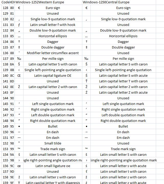

    As mentioned when IBM got seriously into a PC attempt, they introduced a "Code page 437 (IBM PC)" "extended ASCII" going up to at least 255. It seems that possibly lots of people had their own ideas of what should go where in the space from 128 to 255.
    ANSI, in computing was/is a second American standards idea to the Ascii. Developments at that time may have overwhelmed them.
    If we are talking Microsoft things, we might say they hijacked ANSI a bit, before ANSI had completed their initial discussions, Microsoft having a code page for a system to define something similar to ASCII extended, but not always exactly the same*. It was / is used, but mostly gave/ gives way to Unicode. Because of this strange history, around the mid 1980’s, Microsoft talked about ANSI as the new improved thing compared to ASCII - It became a general term, a historical reference misnomer, for the default code page of a given operating system, such as Windows*.
    If we are talking Microsoft VB things, we might say VB only understands ANSI characters
    From the code page you can go on to find the actual characters
    Small differences leading to corruptions
    It was like this: ANSI, the institution, people where in the process of defining a standard for how to display character data on a computer in the 1980’s. Their start point was the 8 Bit, single Byte, 0-255 numbers, and they thought the first 127 where best left at the already known and used Ascii Standard, but they also recognised that the second 128 characters would not be enough, so they also first introduced the idea they called a single code page, to define the second upper 128 character number, or code point in memory, to be a bit more technically explicit. So the idea would be that a code page that made the best compromise in their opinion or bribed by lobbying opinion, fort the best possibly world wide exchange of text information. But they were not finished, when commercial pressures forced Microsoft to highjack the idea and take it further a bit more quickly. Microsoft ended up with many code pages, and other people developed their code page as well.
    Finally ANSI came up with the ISO 8859-1 standard. Microsoft had at some point a code page very close to this, Windows code page 1252. There can be other slight deviations from the actual first 256 in use anywhere. This can lead to problems such as we had at excelfox.com a few years ago

  4. #14
    Text output of the first 255 in typical lists.
    These are generally regarded as the ASCII or ANSI things, which cover most all day English character things.
    This just gives a general idea, since the columns are a bit messed up and things are not always showing correctly in the following attempt. Best is to look at the worksheet in the uploaded file, as an Excel spreadsheet generally shows a very large number of these things correctly. A text file is not too bad, but the positioning of the columns often gets messed up

    254	ţ	        	þ        Latin small letter thorn	 	þ
    255	˙	        	ÿ        Latin small letter y with diaeresis	 	ÿ
    ' **Note: regarding the two columns with MS "ANSI lists" 0-127 and128-255( Columns G and H in uploaded file)
    ' Microsoft Character list 0-127, - is usually the same as ASCII
    ' Microsoft Character list 128-255, - Windows default. However, values in the ANSI character set above 127 are determined by the code page specific to your operating system. (Windows-1252 or CP-1252 (Windows code page 1252) is a legacy single-byte character encoding that is used by default (as the "ANSI code pageage") Microsoft Windows

    Get your bottom end Chr(x) List
    First things first. Make sure you know what characters your current computer has in its AASI character list. It will be similar to ChrW(x) , with x = 0 to 255, but unlikely exactly the same and this might cause awkward issues later if you are unaware of the differences, so it is a good idea to get this list at an early stage. Remember also that it may be slightly different list for different computers.
    The simplest way, Rem 1 in the coding below, is to get this list is to simply loop for x = 0 to 255 and paste out Chr(x) as in the next simply coding. While we are at it we will get our windows code page number then go on to check our list with any published table for that windows code page number: Remember you may get slightly different results on your computer
    In Rem 2 I obtain the windows code page. So far I have seen 1250 and 1252. I researched the internet using those numbers and obtained the appropriate lists which amongst other things are included the table examples below
    Option Explicit ' https://eileenslounge.com/viewtopic.php?p=324440#p324440
    Private Declare Function GetACP Lib "kernel32" () As Long
    Sub GetMyBottomEndAASIs() ' https://www.excelfox.com/forum/showthread.php/2824-Tests-Copying-Pasting-API-Cliipboard-issues-and-Rough-notes-on-Advanced-API-stuff?p=24947&viewfull=1#post24947
    Rem 1 make my own list
    Dim Ex As Long
        For Ex = 0 To 255
         Let Range("H" & Ex + 4 & "") = Ex
         Let Range("I" & Ex + 4 & "") = Chr(Ex)
        Next Ex
                                         Let Rows("14:14").WrapText = False: Debug.Print Asc(Range("I" & 14 & "").Value)    '    This line is a small bodge to remove any automatic wrap text feature that may adjust the cell height seen when it recieves the line feed character  (  Chr(10)  vbLf  )     :     The  Debug.Print  is a quick check  to make sure we still have the character there
    Rem 2 get the windows code page number     ( ' https://eileenslounge.com/viewtopic.php?p=324443#p324443 )
    Dim WindowsCodePageNumber As Long
     Let WindowsCodePageNumber = GetACP()
    Debug.Print WindowsCodePageNumber ' so far I have seen   1250    and the most common one which is   1252
    Here I am just collecting a few lists of Chr(x) , with x from 0 to 255 , and typically alongside I will have a code page list. The significance has been touched on above, and will be discussed further later. Any reference names are for me to tie up list to some of my computers
    ' https://i.postimg.cc/Kj0YvV3Z/Windows-CPage-KB1252.jpg
    ' https://i.postimg.cc/BZVgVzkc/Window...ungary1250.jpg
    Central Europe    (my Hungary  SSD2)	 		More typical (Western Europe)
    x	Chr(x)	Win1250	MS-DOS852	MS-DOS852		x	Chr(x)	Win1252	MS-DOS850

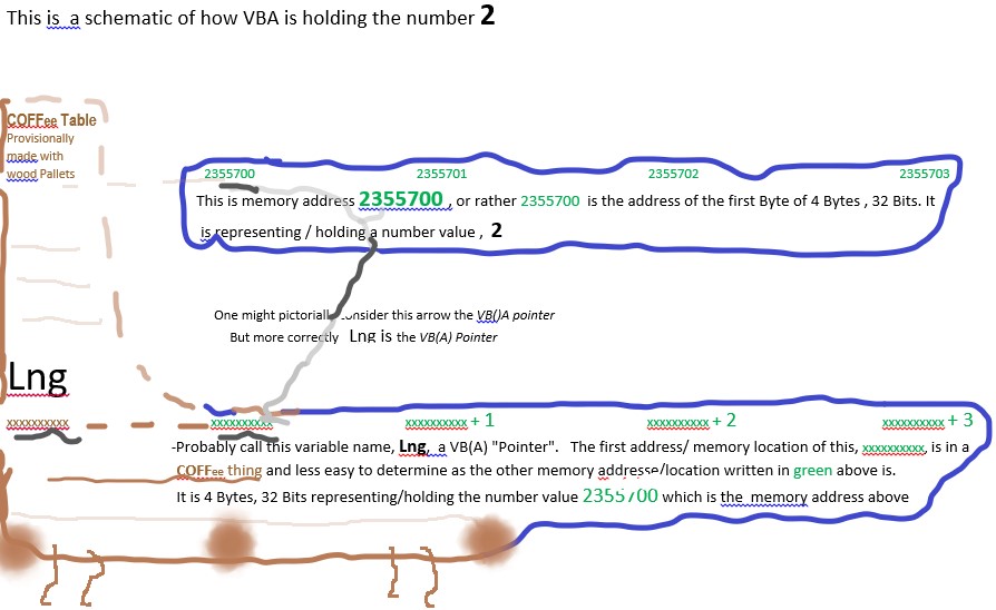

     Let Lng = 2
    5 Debug.Print VarPtr(Lng)          '  2355700
    6 Debug.Print VarPtr(ByVal Lng)    '  2
    8 Debug.Print Lng                  '  2
    (** Pointer values are not unique, neither across different computers or in the same computer and software at different times. The method used to allocate them may result coincidentally occasionally in getting the same number for a short time period, for re runs of the same simple coding on the same computer )
    Starting at the very bottom, and from after line 1 of the coding, a number, that usually referred to pointer , will be stored somehow, somewhere in the computer. The actual location of this requires an in depth low level knowledge of which is perhaps really too complicated and of much too little importance for us to consider. Surfice to say it goes by the name of Common Object File Format ( COFF ) symbol table, and could perhaps be by a layman be regarded as some sort of stack or shelf arrangement populated by some complex rules allowing software to access as necessary. Our interest starts as what is "in" this , and perhaps some knowledge of its size/ construction would not go a miss.
    It is a number which is made with 4 bytes, (32 bits). It is called a Pointer, often. The actual number refers to the first memory address ( the first memory address at the left hand side) of 4 Bytes (32 bits) set aside in memory to hold the final value which I later assign to the variable, (with Let Lng = 2 ). In other words, the act of doing Dim Lng As Long reserves for me 4 sequential memory addresses/ byte locations, in a sequential row as it were. And the first one, the first byte, at the left as it were, has the memory location got for me with the second code line, Debug.Print VarPtr(Lng) ( by me , I got the value shown in the ' comment - 2355700** )
    The third line, Debug.Print VarPtr(ByVal Lng) , is perhaps giving me the same as the 4th line, which is the value of the variable. For the case of a Long Type it does have a value even before I assign one. It has the value 0. If I assigned it 0 with Let Lng = 0 nothing would change anywhere, (before I do Let Lng = 2 ). What I would have possibly done is changed the value of 0 with 0
    In line 5 , after, Let Lng = 2 , the memory location , 2355700, has not changed, as it never does for the VBA Long type, even if I assign a much different number. This is because It doesn’t need to change, because 32 bits are enough to hold a binary value of any number in the range of the defined number range for a VBA Long type
    Line 6 and line 8: My results suggest that Debug.Print VarPtr(ByVal Lng) and Debug.Print Lng are giving me the same thing – the value it sees at the address, 2355700**.
    ( **The address I got was 2355700 , you will get a similar but different number. )

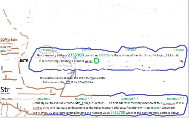

  9. #19
    String experiments note:
    Our main interest in this Thread is the behaviour of the string, but the experiments with the Long above where expected to fit in nicely before considering the string, as they did and do, but also an unexpected bonus was noticed. To experience this Bonus, it would likely be necessary to run the coding in the last post again, immediately before the coding in this post
    String
    String memory handling generally in computing, is a bit more dynamic/ complex than something like for a simple number, since even with modern computers, we don’t want to go around reserving a Giga Byte or two of memory every time we declare a string variable.
    Here is a coding similar to the last
    Sub ConfusedWithVBAandVBStringPointerStuff()
    1 Dim Str As String
    2 Debug.Print VarPtr(Str)        '  2355700   I don't know where this number is held in memory. I don't care.
    3 Debug.Print VarPtr(ByVal Str)              ' 0
    4 Debug.Print StrPtr(ByVal Str); StrPtr(Str) '  0     0
     Let Str = "ABCD"
    5 Debug.Print VarPtr(Str)                                      '  2355700 - makes sense - no reason for this address to change. It is the first Byte of the 4 bytes that holds the VB pointer/ address, whatever value that is
    6 Debug.Print VarPtr(ByVal Str)               '  4028444
    7 Debug.Print StrPtr(ByVal  Str); StrPtr(Str)  '  4028444  4028444
    8 Debug.Print Str
    One immediate unexpected interesting thing is the second code line Debug.Print VarPtr(Str) actually returned me the very same number as the second code line in the coding from the last post, Debug.Print VarPtr(Lng)!! I do realise that will not always be the case, but as I ran the coding shortly after running the previous coding on the same computer, then there is a chance it will be the same, as it was, … because….. how about this: What Dim Str As String in the coding below is doing, is very similar to what the Dim Lng As Long did/does in the coding from the last post, - it sets aside once again 4 Bytes (32 bits) for me. But the difference being now is that it is not reserving me a place to store any final number or character values, rather it is reserving me a place … for …. a …. 32Bit Pointer , specifically a pointer to a VB String
    So I could say, what I have is a VBA Pointer to a VB Pointer, or perhaps a VBA Pointer to what likely will be a VB Pointer – depending on how you feel the word pointer should be used.
    At this stage, after Dim Str As String, and before Let Str = "ABCD", we are at a very similar to the second ( and final ) level in the last diagram, ( the main difference is that we have a value of 0 now instead of the value 2). In the previous diagram, the assignment Let Lng = 2 did not change much other than replacinf a value of zero with a value of 2. In the now case of a string, the Let Str = "ABCD" also does a simple change of value ( from 0 to 4028444 ) but that is not all: We are not at the final level in this case, (and the number that would be finally returned from VarPtr(ByVal Str after we assign the value is not the final, string value , but rather will be the address of the final string, 4028444. (But note also that address is not of the start memory point I finally use for my string, but rather 4 Bytes along where the actual Unicode UTF-16 LE encoding Bytes start. )
    At the point before Let Str = "ABCD" I have no memory at all set aside for any final string value. In crude terms, the final top section from the diagram below does not exist, ( instead I have this situation https://i.postimg.cc/rwGWm2F8/vb-Null-String.jpg ), and the value at memory location 2355700 resembles very similar the situation at code line 4 of the previous coding, having a value of 0. (At this point I could regard this situation as a "vbNullString situation" ## , but that is just something I came up with to help me remember what vbNullString is about )

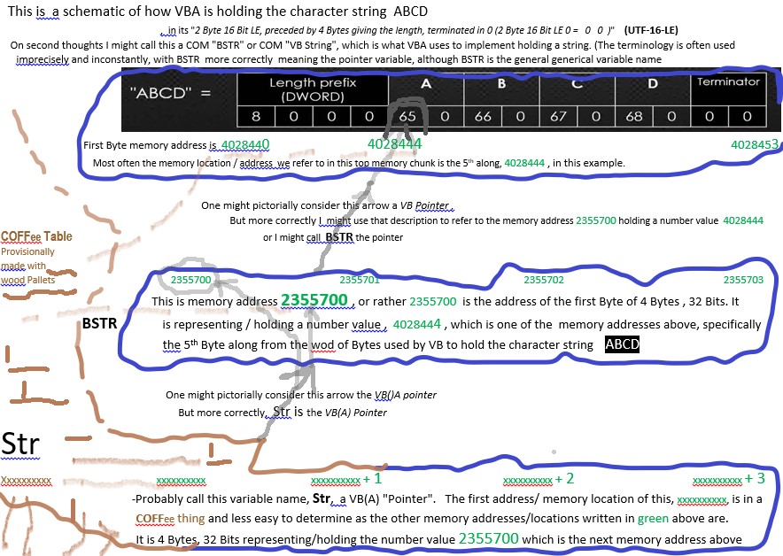

    After Let Str = "ABCD", I have the situation depicted in the diagram below.
    As already noted, the final value returned from VarPtr(ByVal Str after we assign the value is not the final, string value , but rather will be the memory address location of the final string.
    (##Note in passing that after Let Str = "ABCD" the further thereafter use of Let Str = vbNullString allows us to return to the situation at code line 4)
    As for code line 8, I would assume that VB(A) either knows how to navigate along the 2 pointers to get the final value, such as for example going further until it no longer sees a points or some similar innards coding.
    The sketch below illustrates the situation after Let Str = "ABCD" , (which remains the situation until the coding ends, since the following lines change nothing: they just get us some information about the situation.)

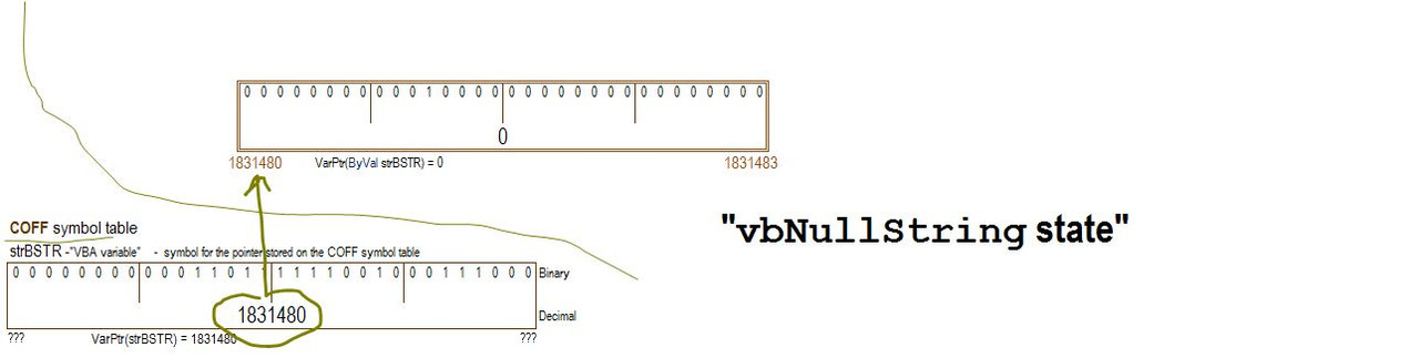

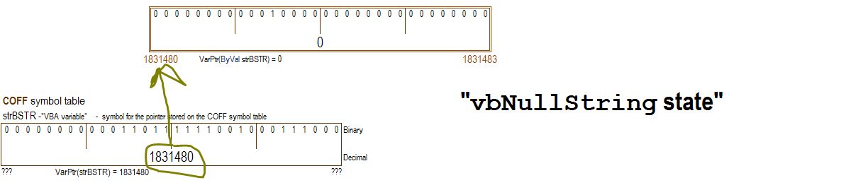

    So at this point we have not really started talking about the BSTR but have mentioned it around the edge, and not really talked much about the LPWSTR, which comes in from another direction as it were….
    At this particular stage, the second box, the dark orange one, has a value of 0, as given by VarPtr(ByVal strBSTR).
    At this point, opinions vary as to whether we actually have anything to do with a BSTR, since generally a pointer has a value, (other than 0). This could be regarded as the vbNullString state. (Later in "more full" string states, the assignment strBSTR = vbNullString would bring us back to this state )
    https://i.postimg.cc/9MjdfkxX/vb-Null-String-state.jpg
    Sub BSTR_LPWSTR() '
    Dim strBSTR As String, strNew As String, Boo As Boolean, pz1PWSTR As Long, pz2PWSTR As Long
    Debug.Print VarPtr(strBSTR) '        1831480        This could be regarded as getting me the variable, strBSTR. It is the symbol for the pointer stored on the COFF symbol table
    Debug.Print VarPtr(ByVal strBSTR) '     0     Our "BSTR Pointer"  is empty at this point
    The olive coloured arrow there might be considered the VBA pointer

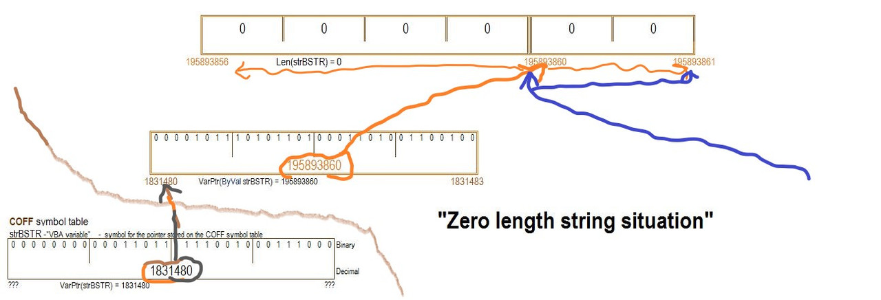

    So I will use the simplest state first, the so called "zero length string" state, as this simply makes the diagram easier to follow
    So the code line Let strBSTR = "" would result is something like this
    https://i.postimg.cc/sXvMGKd8/Zero-l...-situation.jpg
