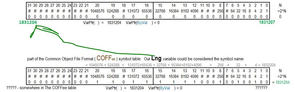

    Code line 1: Lng is strictly speaking the symbol for the pointer held in a stack of active variable that we don’t have easy access to, going by the name of Common Object File Format ( COFF ) symbol table, and could perhaps be by a layman be regarded as some sort of stack or shelf arrangement populated by some complex rules allowing software to access as necessary. Our interest starts at what is "in" this, in other words the number held at this stack/shelf location . It is a number which is made with 4 bytes, (32 bits). It, or the mechanisms associated with it, is/are called a Pointer, often.
    The actual number refers to the first memory address ( the first memory address at the left hand side) of 4 Bytes (32 bits) set aside in memory to hold the final value which I later assign to the variable. In other words, where the first 0/1 value Bit is in the binary representation of a number is. This address is obtained by the first half of code line 2
    I use for this explanation the numbers I got , you will of course get similar sized but different numbers. – Your computer will find an appropriate suitable place at the time you run the coding
    This next sketch is a pictorial representation of that number in that mysterious shelf/stack (COFF symbol Table)
    https://i.postimg.cc/RCXmK1wN/First-...able-value.jpg
    We cannot easily know "where that sketch is".
    The second value at line 2 tells us what number is held at that address. At this stage it will be 0 as the memory location and following 31 bits all have the value 0, representing the final decimal value of 0. At this stage those 32 bits have just been set aside for us to use.

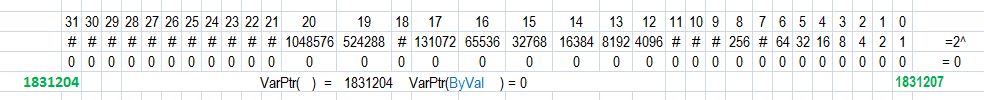

    This next sketch is similar to the last, as it is representing a similar sized memory location, ( 32 consecutive bits ). But this is a different "”place" / memory location , the one being "pointed to" by that number, 1831204 , in that shelf/stack (COFF symbol Table) . This place is being used currently to represent a value of zero, which it will be set to by default when it is set aside for us to use. We know "where this is". It starts at memory location 1831204, and ends 31 bits (4 bytes), further along at 1831204 + 3 = 1831207
    https://i.postimg.cc/J0mxTCLL/Memeoy...ng-value-0.jpg
    Code Line 4 in the first Called procedure returns the same values as code line 2. This is because the code lines are the same, and, importantly for our discussions, they are referring to the same variable, the same "place" depicted above. This is arranged by the use of ByRef in the Called Sub ByRefLong(ByRef Lnge As Long) We could think in simple layman terms, that in the first main procedure, Sub ByValByRefWithPointersLong() and the first Called procedure , the variables Lng and Lnge are in effect the same variable.

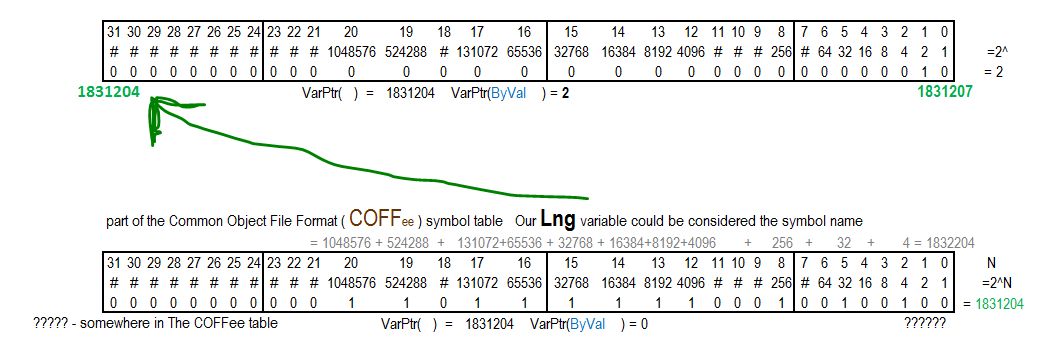

    Code line 5 in the first Called procedure, then changes the value in the 32 bits there to a binary set of 0/1 digits representing the decimal value of 2. So not much has changed there: This is what it looks like now:
    https://i.postimg.cc/6q00gbWG/Memeoy...ng-value-2.jpg
    Just to make that all clear again, the story so far:
    VarPtr(Lng) has returned us the number held in some place we do not have easy access to. That number , 1831204 , is the memory address of the first bit on the left of 32 bits reserved for us to hold the actual final value that we want to "have in the variable"
    VarPtr(ByVal Lng) gives us the decimal value held in those 32 bits at any time. Originally it was set by default to zero, and at some point we changed it to 2
    As we now move on, back in the main procedure. at code line 7, the two values returned remain at the values obtained / last set, within the first Called procedure: These are now the values as they stand in the main procedure: the address location of our original variable will never change as long as the coding runs, but we changed the value effectively at that address within the first Called procedure, - we were able to do that change to the value of 2 as effectively, in simple terms, Lng and Lnge were the same variable.
