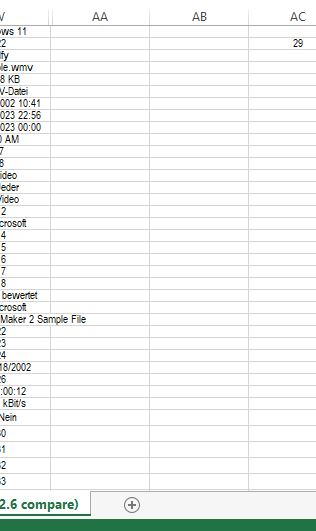

Open just WSO_PropNames.xls, it should look something like this, with columns AA and AB empty
https://i.postimg.cc/QN9RhZsF/Before...ll-Details.jpg
Attachment 5732https://i.postimg.cc/NLtNkVKt/Before...ll-Details.jpg

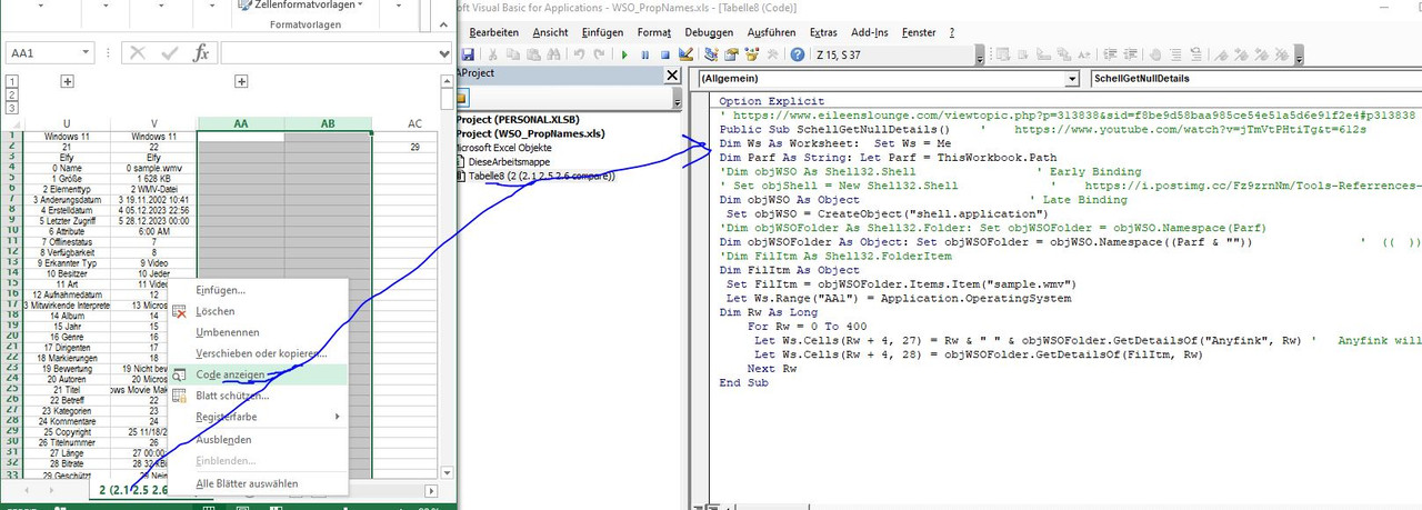

Now run the only macro in it, WSO_PropNames.xls and run Sub SchellGetNullDetails() ( Tabelle8.SchellGetNullDetails

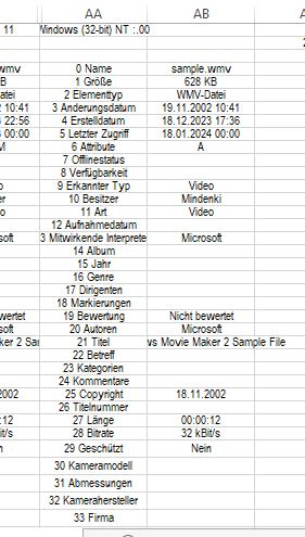

After running that coding, you should see something approximately like this
https://i.postimg.cc/ZRg2pVPY/After-...ll-Details.jpg
Attachment 5734https://i.postimg.cc/YG6dwNyT/After-...ll-Details.jpg
