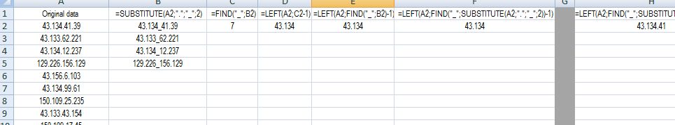

    In the uploaded file I go through a typical formula development. I tend to start with a typical data in the first cell then develop formula in the columns to the right.
    https://postimg.cc/T5J1zVbs
                   =SUBSTITUTE(A2;".";"_";2)  =FIND("_";B2)  =LEFT(A2;C2-1)   =LEFT(A2;FIND("_";B2)-1)  =LEFT(A2;FIND("_";SUBSTITUTE(A2;".";"_";2))-1)
    In simple wording what I do is: get the information, or make the changes I need to, using a formula in a cell in the columns, and then when I am finally at a working formula, (which will be at this point typically using the cells in the columns), I work backwards as it were, substituting into the column cell range the actual formula in that referenced column cell, the final goal being to have a formula only needing the original data.
    It is difficult to easily explain that in words, or if it is, then it is probably quicker to take a look at, and fiddle a bit with, the cells, and you then should quickly see what is going on.
    But here is a quick explanation anyway, taking the first data in cell A2,
    43.134.41.39
    In B2 I change the second . to a _
    In C2 I find position along of that _
    I now have the information I need to use the LEFT function to take just the left part of the data that I want. So at this point I have the working formula, but it has cell references in it. I don't want that, or rather I do, but only the original data reference, in this case A2
    From then on I replace cell references in the formula with the actual formula in the referenced cell. I keep doing this until I finally only am referencing the actual data cell, A2, in this case

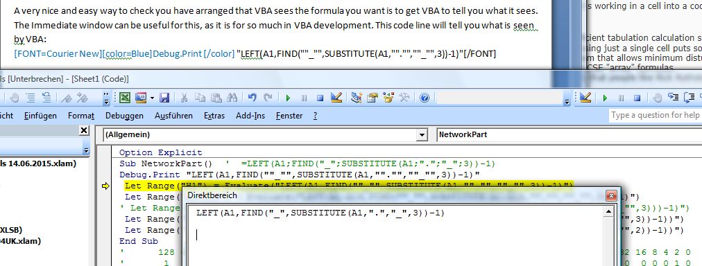

    A very nice and easy way to check you have arranged that VBA sees the formula you want is to get VBA to tell you what it sees.
    The Immediate window can be useful for this, as it is for so much in VBA development. This code line will tell you what is seen by VBA:
    Debug.Print "LEFT(A2,FIND(""_"",SUBSTITUTE(A2,""."",""_"",2))-1)"
    That would give us printed in the Immediate Window
    LEFT(A2,FIND("_",SUBSTITUTE(A2,".","_",2))-1)
    https://i.postimg.cc/Yqkd7nDj/Debug-...ate(Range).jpg

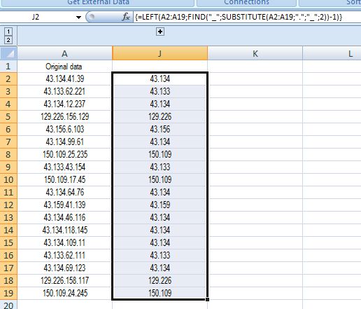

    Coming back to the spreadsheet, in the example in the uploaded file I have a set of data in the range A2:A19.
    If I were to
    _ select the range J2:J19
    _ type in this formula =LEFT(A2:A19,FIND("_",SUBSTITUTE(A2:A19,".","_",2))-1)
    _ Hold down the Ctrl and Shift Key Whilst hitting the Enter key,
    , then I should get a full set of results.
    https://postimg.cc/rz0Qd45k
    What we have done there is the classic CSE ( type 2 ) Excel "array formula" , which allows us to get multiple results from a single formula.
    In VBA coding we no longer have this manually made connection to the spreadsheet, but never the less, it is often enough to put such a formula into the Evaluate(" "), and the correct array of results is returned.
    In our example, the VBA code line would be
    Let Range("I2:I19") = Evaluate("LEFT(A2:A19,FIND(""_"",SUBSTITUTE(A2:A19,""."",""_"",2))-1)")

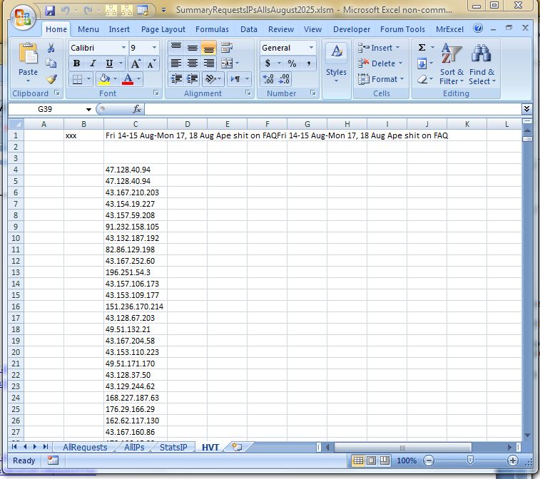

    Te similar part IP addresses will be consolidated and ordered in order of most used in a similar way to how t full IP address list is.
    This new worksheet, coding, and results will go initially in the "Alls" summary files, such as
    SummaryRequestsIPsAllsJuly2025.xlsm

    The two lists have the IP address trimmed to the form of like 43.134 ____ 43.134.49

    Rem 2 Trim IPs columns from the right   https://www.excelfox.com/forum/showthread.php/3007-A-Semi-automated-way-to-note-the-IP-addresses-of-things-viewing-us?p=27704&viewfull=1#post27704    https://www.excelfox.com/forum/showthread.php/3007-A-Semi-automated-way-to-note-the-IP-addresses-of-things-viewing-us?p=27705&viewfull=1#post27705
     Let rngC1 = Evaluate("IF({1},LEFT(" & rngC1.Address & ",FIND(""_"",SUBSTITUTE(" & rngC1.Address & ",""."",""_"",2))-1))")
     Let rngC3 = Evaluate("IF({1},LEFT(" & rngC3.Address & ",FIND(""_"",SUBSTITUTE(" & rngC3.Address & ",""."",""_"",3))-1))")

    These next couple of codings will get us as far as the IP addresses listed in the new worksheet, HVT ( for High View Things or High View Threads ) , in
    SummaryRequestsIPsAllsAugust2025.xlsm
    https://postimg.cc/q6GPrm92 , https://i.postimg.cc/G90dkVKg/New-Worksheet-HVT.jpg
    You will be expected to select the cell that has a lot of IP addresses in it, then run either of two codings.
    The first alone is preferable as the only to run, using the data from a single cell in the consolidated file, SummaryRequestsIPsAllsAugust2025.xlsm ,
    For the problem case scenario of the cell string text length exceeding 32767 characters, it will be necessary again to select the first cell of interest cell that has a lot of IP addresses in it, but in the Daily’s file, SummaryRequestsIPsDailys__.xlsm , then run first the first coding, then , thereafter, when selecting further cells, the second coding is used to tack on the other IPs
