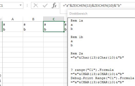

    _ If we are in in non English Excel, as I am, we can type either of these in the Immediate window to get the English syntax.
    ? range("C1").Formula
    Debug.Print range("C1").Formula

    https://i.postimg.cc/j2SJH7tY/a-CHAR-13-CHAR-10-b.jpg

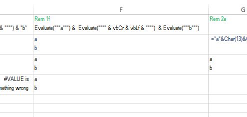

    ' 1c(i)                             Note    Evaluate(vbCr & vbLf)   in watch gives     gives    Watch :   : Evaluate(vbCr & vbLf) : Fehler 2015 : Variant/Error
                                                                        Debug.Print "Rem 1c(i)": Let Range("D1") = "Rem 1c" & _
                                                                        vbLf & """" & "a" & """" & " " & "&" & " Evaluate" & "(" & "vbCr " & "&" & " vbLf" & ")" & " " & "&" & " " & """" & "b" & """"
                                                                                                 Let Range("D1").Characters(Start:=1, Length:=7).Font.Color = -11489280: Let Range("D1").Characters(Start:=8, Length:=33).Font.ColorIndex = xlAutomatic
           Debug.Print "a" & Evaluate(vbCr & vbLf) & "b" ' Fatal                        Type Mismatch Error
     Let Range("D3") = "a" & Evaluate(vbCr & vbLf) & "b" ' Fatal                        Type Mismatch Error
    ' Call WtchaGot_Unic_NotMuchIfYaChoppedItOff("a" & Evaluate(vbCr & vbLf) & "b") 'Fatal Type Mismatch Error
     Let Range("D4") = Evaluate("a" & Evaluate(vbCr & vbLf) & "b") ' Fatal      Type Mismatch Error
    Stop: Call TidyCellView: Debug.Print
    ' 1c(ii)                            Note    Evaluate("""" & vbCr & vbLf & """")  Watch :   : Evaluate("""" & vbCr & vbLf & """") : "
                                '                                                                                                       " : Variant/String      if copied here, but looks like     "  "     in the watch window       https://i.postimg.cc/L6C24trX/Warch-Window-dont-display-a-line-break.jpg
                                                                        Debug.Print "Rem 1c(ii)": Let Range("E1") = "Rem 1c(ii)" & _
                                                                        vbLf & """" & "a" & """" & " " & "&" & " Evaluate" & "(" & """" & """" & """" & """" & " " & "&" & " vbCr " & "&" & " vbLf " & "&" & " " & """" & """" & """" & """" & ")" & " " & "&" & " " & """" & "b" & """"
                                                                                                  Let Range("E1").Characters(Start:=1, Length:=11).Font.Color = -11489280: Let Range("E1").Characters(Start:=12, Length:=47).Font.ColorIndex = xlAutomatic
                       Debug.Print Evaluate("""" & vbCr & vbLf & """") ' This seems to take the cursor down 2 places, but as  Debug.Print  takes routinely the cursor down once, our bit must have took it down once
           Debug.Print "a" & Evaluate("""" & vbCr & vbLf & """") & "b" ' shows          a
    '                                                                                   b
     Let Range("E3") = "a" & Evaluate("""" & vbCr & vbLf & """") & "b" ' shows in cell  a
    '                                                                                   b
     Let Range("E4") = Evaluate("a" & Evaluate("""" & vbCr & vbLf & """") & "b") ' In cell  #WERT!  -  it appears to be returning  Error 2015
                                                                                           Let Range("E4") = "#WERT!                                         #VALUE is Excel's way of saying, ""There's something wrong with the way your formula is typed. Or, there's something wrong with the cells you are referencing."" The error is very general, and it can be hard to find the exact cause of it"

    Using Debug.Print to aid in string construction
    Even with a good understanding of quotes in VBA, it is very easy to make a mistake. This general rule can help:
    Printing out the string you have attempted to construct in the immediate window, will show it as VBA sees it after compile, and shows what VBA, after compile, will be trying to put in a cell via a code line like
    Let Range("C1") = The string you have constructed
    So, that string shown in the immediate window must be syntaxly kosher for an Excel cell, in otherwords it must look like the string as you would manually write it in a cell. So for putting a formula in a cell, something like this would be OK
    = "a" & "b"
    , resulting in the value
    ab
    showing in the cell, ( and in the formula bar you will see = "a" & "b" , just as in the immediate window )
    On the other hand, something like these showing for a Debug.Print of your constructed string, would likely error when used
    = "a" & b"
    = "a" & ""b"
    = ""a"" & "b"
    So finally, in ' 2a we have a string construction that we are happy with to put a formula in a cell which will be the Excel spreadsheet formula, ="a"&Char(10)&Char(13)&"b" , as indeed we see both in the formula Bar, and in the immediate window if using
    Debug.Print "=" & """a""" & "&" & "Char(13)&Char(10)" & "&" & """b""" & ""
    To briefly explain that final string construction in words
    ______ "=" & """a""" & "&" & "Char(13)&Char(10)" & "&" & """b""" & ""
    The outer most quotes are those always required in VBA to signalise that we are giving literal text.
    Within those outer quotes, in VBA coding we may build up the string from further string elements. (The string can also be built up from VBA things returning strings or numbers, as we will do in the next post. Here we are only using other string elements), The syntax of VBA will require further enclosing quotes for every further string elements, and furthermore, VBA syntax requires an ampersand symbol, _ & _ , to join these strings, thus
    ______ "__" & "¬¬¬¬____" & "asskasasaf"
    In green is the literal text, as we would write it in a cell.
    Excel spreadsheet syntax requires in the final written cell formula text ampersands, & , which will be here literal text, hence must be enclosed with VBA quote pairs, thus
    Finally, the Excel spreadsheet syntax requires that a literal text such as the character a, must be enclosed in the cell in quotes, but as we discussed in quotes in VBA something like this would error , ""a"" , we require to effectively double quote where we want a final single quote in the final string , """a"""
    The final value in the cell would be
    a
    b
    We have there 4 characters, pseudo like, (and it’s a bit subjective/ arbitrary of me, how I show them here in this pseudo form, just for explanation purposes: )
    a vbCr
    vbLf
    b
    Some final minor notes:
    _ Once we have the final string, we can often simplify, mainly by removing some VBA joining bits, since they are redundant when linking only literal text – the text can simply appear together.
    ______ "=""a""&Char(13)&Char(10)&""b"""
    However, from experience I would only do this, if ever, at a final stage, since the careful explicit constructions are usually easier to build up and debug. Indeed, with hindsight, I might separate all the final cell texts of "a" and "b", as shown within the VBA construction, into the 3 characters of a quote, an a , and a final quote, just so as to make them clearly correspond to the explanations given of the quotes in VBA
    ______ "=" & """" & "a" & """" & "&" & "Char(13)&Char(10)" & "&" & """" & "b" & """" & ""
    In words, just as you would write in the cell ,
    a quote "
    a
    a quote "
    a ampersand &
    a quote "
    the two joined text (functions), Char(13)&Char(10)
    a ampersand &
    a quote "
    b
    a quote "
    So we have done the background revision and can move on in the next post to the problem / issues with vbCr & vbLf in formulas and Evaluate(" "), well almost

    Let’s do that in a separate coding, Sub CarriageReturnLineFeedExcelVBAEvaluateTextFormula( )
    Sub CarriageReturnLineFeedExcelVBAEvaluateTextFormula()  '   https://www.excelfox.com/forum/showthread.php/2909-Appendix-Thread-Evaluate-Range-(-Codes-for-other-Threads-HTML-Tables-etc-)?p=24087&viewfull=1#post24087
    On Error GoTo Bed
    '                         A few things to make things in the demo look closer to what they are
     Call TidyCellView   '    When experimenting it may be a good idea to occaisionally do this again, as Excel occaisionally may change things if it geusses incorrrectly what we want to see
    ' 1f   Finally
                                                                        Debug.Print "Rem 1f": Let Range("F1") = "Rem 1f" & vbLf & _
                                                                        "Evaluate(" & """""""" & "a" & """""""" & ")" & " & " & " Evaluate" & "(" & """" & """" & """" & """" & " " & "&" & " vbCr " & "&" & " vbLf " & "&" & " " & """" & """" & """" & """" & ")" & " " & " & " & "Evaluate(" & """""""" & "b" & """""""" & ")"
                                                                                                  Let Range("F1").Characters(Start:=1, Length:=6).Font.Color = -11489280: Let Range("F1").Characters(Start:=7, Length:=78).Font.ColorIndex = xlAutomatic
           Debug.Print Evaluate("""" & "a" & """") & Evaluate("""" & vbCr & vbLf & """") & Evaluate("""" & "b" & """")
     Let Range("F4") = Evaluate("""" & "a" & """") & Evaluate("""" & vbCr & vbLf & """") & Evaluate("""" & "b" & """")
    Exit Sub
    Bed:
    Debug.Print Err.Number
    Debug.Print Err.Description
    Resume Next
    What have we done.
    Let’s put into words what we have done, as it will help in the next post sections, when we do putting formulas into cells with Evaluate("")
    We created a full string for VBA equivalent to
    "a" & vbCr & vbLf & "b"
    "a" was got from this Evaluate("""" & "a" & """")
    vbCr & vbLf was got from this Evaluate("""" & vbCr & vbLf & """")
    "b" was got from this Evaluate("""" & "b" & """")
    But, and this is important,
    The three Evaluates effectively did these three things:
    It got the result as if we typed in a cell ="a" which resulted in a
    It got the result as if we typed in a cell ="the character for a carriage return" & "the character for a carriage return" which resulted in a visible line break, or second line, or however you personally describe that
    It got the result as if we typed in a cell ="b" which resulted in b
    Evaluate got us the 3 results from a formula, as if I typed the formula in a cell in a cell
    https://i.postimg.cc/vmSF6JBH/Column-F-results.jpg

    ' 2a CHAR(13)&CHAR(10)
    CHAR(13)&CHAR(10) is recognised Excel syntax. The Characters of a and b are not
    VBA wants to see the following string in order to put the formula = "a" & CHAR(13) & CHAR(10) & "b" into the cell
    "=""a""&CHAR(13)&CHAR(10)&""b"""
    In other words, if I wanted to use VBA to put this formula in cell B10,
    , ( as an alternative to me physically typing this in ), then I would need a code line like
    Range("B10") = "=""a""&CHAR(13)&CHAR(10)&""b"""
    So producing all those bits on the RHS using Evaluate(" ") on the RHS requires carefully producing each of those 18 things from what we have learned is how they need to look like within the Evaluate(" ") string:-
     """" & "=" & """" & """" & "a" & """" & """" & "&" & "CHAR (13)&CHAR(10)" & "&" & """" & """" & "b" & """" & """" & """"
    With the previous knowledge, it’s fairly straight forward.
    Here saying it again. In words what we have done is: We consider the string that VBA wants to have , in its simplest form. ( It must be in the simplest form without any of the VBA " & " bits, since Evaluate(" ") in this use if it is only going to return to us a simple string, not a code line. By the same reasoning the Evaluate(" ") won’t give any other VBA things like variables and functions, so the " & " is not needed anyway. – ( It would be needed to link string text to other things like VBA variables and functions and formulas, in which case it would have this sort of form , missing one of the quotes, __ "words " & VBA stuff & " other words" )
    We then make the string for evaluate, strEval . We do this by consigöring each Character in turn of this string we need in VBA, "=""a""&CHAR(13)&CHAR(10)&""b""" – Let’s open that out just to make it easier to see all those 18 bits
        "      =      "      "      a      "      "    &     CHAR(13)&CHAR(10)   &      "      "      b      "      "      "                                              ' For VBA
    For each of the 18 things there, we know the equivalent to have inside Evaluate(" ")
    Each of those is then joined by a " & "
    Here is that working result again
       """" & "=" & """" & """" & "a" & """" & """" & "&" & "CHAR(13)&CHAR(10)" & "&" & """" & """" & "b" & """" & """" & """"
    What finally is returned from the RHS and seen by VBA and then put in the cell is, as we would physically write it
    ="a"&CHAR(13)&CHAR(10)&"b"
    A final simplification can be made to the evaluate string by removing all the " & " bits
    _"""=""""a""""&CHAR(13)&CHAR(10)&""""b"""""""
    or **
    "=""=""""a""""&CHAR(13)&CHAR(10)&""""b"""""""
    One last things that will be useful to compare with the over next section. ' 2b(ii) , will be
    the Debug.Print of the string to be used in Evaluate(" ") strEval , _____ and the formula finally put in the cell and seen in the formula bar
    __ "=""a""&CHAR(13)&CHAR(10)&""b""" ________ ="a"&CHAR(13)&CHAR(10)&"b"
    ' 2b vbCr & vbLf
    ' 2b(i)
    We might want to go back a bit to some of the conclusion attempts here https://www.excelfox.com/forum/showt...ll=1#post24055
    We said along the lines of that vbCr & vbLf was actually a text of two Characters, not much different to like xy. Even if we say that we know that vbCr & vbLf is a VBA text construct thing, used when building up a string in VBA, then that still does not help us to get anything useful out of Evaluate(vbCr & vbLf), (and this does nothing at all for us either Evaluate("" & vbCr & vbLf & "") )
    This is a consequence of our better understanding of Evaluate(" ") in that it calls out an exposition of the underlying functionality, of the fundamental Excel object to which is named. This strange looking constant, vbCr & vbLf makes no sense to Excel.
    Doing this Evaluate("""" & "a" & """") gives us the same results as putting ="""" & "a" & """" in a cell and the result from that world be ,
    "a"
    , ( regarding the extra = see ** ) That "a" is the required string to present in VBA on the RHS to put an a in a cell
    To this consideration of the character a is a parallel to the Characters vbCr & vbLf - Doing this Evaluate("""" & vbCr & vbLf & """") gives us the same results as pseudo putting ="""" & "NewLineCharacters" & """" in a cell, although that pseudo syntax, NewLineCharacters , is not recognised, but the underlying shared innards working does the same, and the result from that world be, … well a bit difficult to show, but something pseudo like ,
    _"
    That is effectively the required string to present in VBA on the RHS to put those two Characters in a cell.
