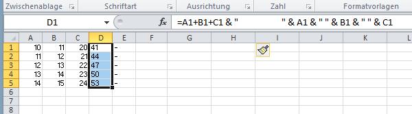

     Let Selection = "=A1+B1+C1 & ""                     "" & A1 & "" "" & B1 & "" "" & C1"   '     This line is like putting this formula in cell D1    =A1+B1+C1 & "          " & A1 & " " & B1 & " " & C1         and dragging it down
     Let Selection = Selection.Value                                                          '     line changes the cell values to the value the formula gives, rather than the formula, ( this is necessary so that I can still everything as I initially do in the sum result column, even if I delete the columns A - C
    The first code line is like putting this formula in cell D1
    https://i.postimg.cc/wjvSJ59s/First-...1-A1-B1-C1.jpg
    , and then dragging it down.
    The second code line changes the cell values to the value the formula gives, rather than the formula, ( this is necessary so that I can still everything as I initially do in the sum result column, even if I delete the columns A - C

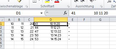

    That way is just my preference for a few reasons:
    _ Text and text storage in computers is, as I understand it as a computer Layman, cheap and easy these days, so having a lot of text anywhere idoes no noticeable harm or performance degradation
    _ I would probably have things in the next column and my columns are not usually very wide., so I usually only see the results clearly, but if need be, to get full information ,I can extend the column , look in the formula bar or copy cells or a cell, etc.
