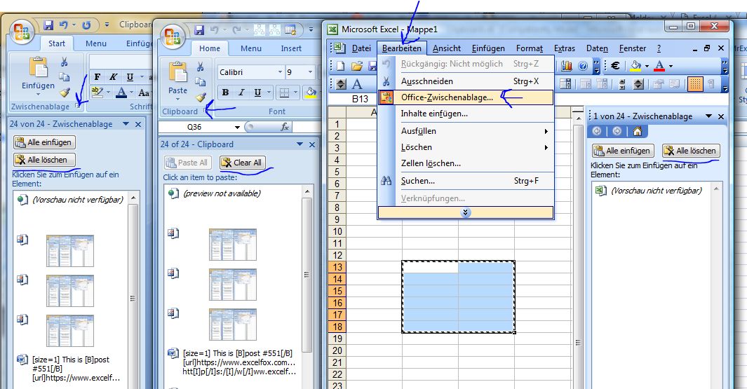

    This smaller coding below is an alternative to the big one in the previous post.
    It’s based on some experiments done by Jaafar Tribak in 2019 , when he was trying to get a coding to work in Office 2016. Whilst he failed at the time to get a solution to work in Office 2016, some of us possibly overlooked that this basic coding idea worked in Office 2013 and lower.
    So we did at least have another smaller alternative solution to the big one in the previous post.

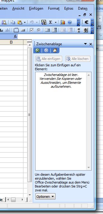

        If CLng(Val(Application.Version)) <= 11 Then  '       Case 11: "Excel 2003" Windows  "Excel 2004"
         Let MyPain = "Task Pane"
         Let MyPain = "Office Clipboard"
    Set avAcc = Application.CommandBars(MyPain)   '
    Let bClipboard = avAcc.Visible
        If Not bClipboard Then
         Let avAcc.Visible = True
         DoEvents
        For j = 1 To 4                '  J=  1, 2, 3, 4
         AccessibleChildren avAcc, Choose(j, 0, 3, 0, 3), 1, avAcc, 1
    avAcc.accDoDefaultAction 2&  '       This seems to do the clearing                     1& for paste
    Let Application.CommandBars(MyPain).Visible = bClipboard         '

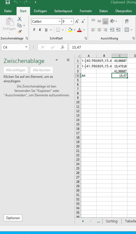

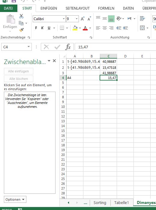

    This is my latest attempt as of October 2024 for a small coding version that will work across Office versions from 2003 up to the latest.
    For recent discussions, see here
    https://eileenslounge.com/viewtopic....321822#p321822
    https://eileenslounge.com/viewtopic....321817#p321817
    https://eileenslounge.com/viewtopic....321820#p321820
    https://eileenslounge.com/viewtopic....321821#p321821
    https://stackoverflow.com/questions/...37208#79137208

    Sub small_20202024_ClearOfficeClipBoard_()  ' https://eileenslounge.com/viewtopic.php?p=319159&sid=a5636ddee2213f0629c9f46423c324c5#p319159
    Dim avAcc, bClipboard As Boolean, j As Long
    Dim MyPain As String
        If CLng(Val(Application.Version)) <= 11 Then  '                   Case 11: "Excel 2003" Windows    "Excel 2004" mac
    Let bClipboard = avAcc.Visible      '   bClipboard will be false if the viewer pain is not open
         avAcc.Visible = True           '   This opens the Viewer pain. The coding won't work if it is not open
         DoEvents: DoEvents
    '   coding change for Office versions at  --  Office 2016  ==
        If CLng(Val(Application.Version)) < 16 Then
    ' --For Office versions 2003 2007 2010 2013 ----------------------------------------
            For j = 1 To 4         '      J =    1  2  3  4
         avAcc.accDoDefaultAction 2&  '           This seems to do the clearing   It will NOT error if viewer pain is already  Cleared                  1& for paste
    ' ==For Office versions 2016 and higher ==============================================
