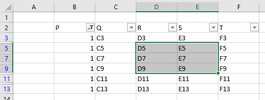

    Here is the code for the new scenario.
    Sub ScenarioB() Dim Dest As Range 'Remove the AutoFilter if any If ActiveSheet.AutoFilterMode Then Cells.AutoFilter 'Clear all cells Cells.Clear 'Refer to some cells Set Dest = Range("B2:F12") With Dest.Offset(1) 'Write a formula into to get the address of the cell .Formula = "=ADDRESS(ROW(),COLUMN(),4)" 'Write 1 or 0 into the fist column .Columns(1).Formula = "=MOD(ROW(),2)" 'Convert the formulas to values (using a 2D-array "on the fly") .Value = .Value End With 'Add Headers With Dest.Rows(1) .Formula = "=LEFT(ADDRESS(ROW(),COLUMN(P1),4),1)" .Value = .Value End With 'Add an AutoFilter Dest.AutoFilter 'Filter the first column Dest.AutoFilter 1, 1 'Select some cells in there Dest.Offset(2, 2).Resize(6, 2).Select End Sub
    And here is how it looks like:
