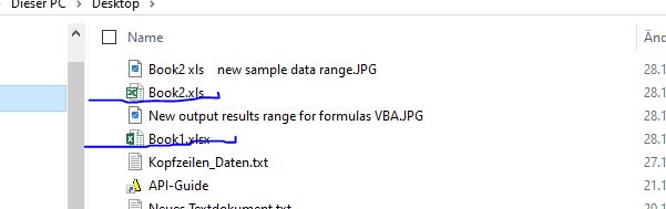

    I think it helps with this demonstration to include another sample data rage which I will include in a separate new workbook, Book2.xls . For the demonstration solution to work, you will need to download both workbooks, Book1.xlsx and Book2.xls to the same place , (but a final solution does not have to have this restriction: Files can be anywhere as long as you know where.
    Note that it is only necessary to have Book1.xlsx open for these demonstrations to work. The other workbook, Book2.xls , can be open or closed. This is because I am applying a closed workbook reference to retrieve values from a closed workbook, which is possible in Excel without VBA. (I am creating the closed workbook formula for convenience with VBA, but it is not necessary: you can add those formulas manually).
