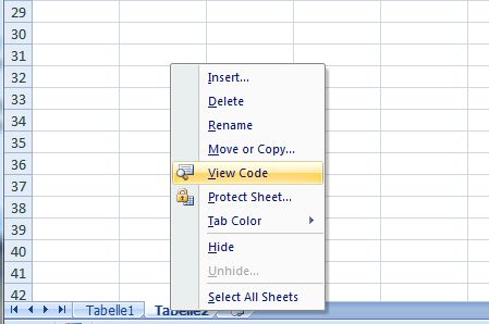

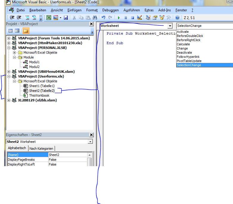

    Use Keys Alt+F11 from Excel to get the VB Editor
    , or alternatively
    , right click on any worksheet tab and select view code, - https://i.postimg.cc/J04LpnsW/Right-...eet-coding.jpg
    Attachment 5865
    ,That will show you initially a representation of some of the existing Excel objects associated with your file, which usually by default will be for the workbook itself, ThisWorkbook, and the worksheets you have. (If you took this second approach to get the VB Editor then initially the big window will be for any coding you may add for the worksheet who’s tab you selected.)
    https://i.postimg.cc/nh69N8KW/Big-wi...u-selected.jpg
    Attachment 5866

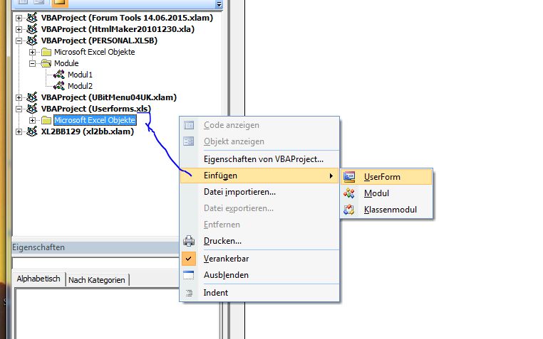

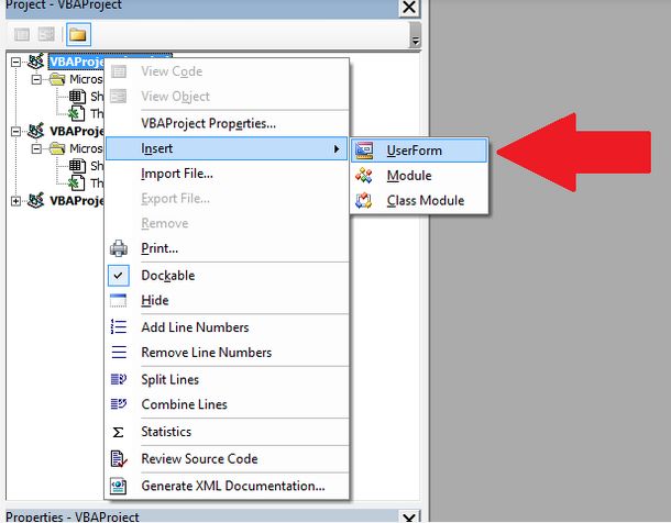

    "Get one" with a bit of right clicking near the representation of your Excel file in the left hand VBA project window of the VB Editor,
    https://i.postimg.cc/GmZzK54L/Do-a-b...-Form-opti.jpg , https://i.postimg.cc/kgVfxmXY/Do-a-b...orm-option.jpg
    Attachment 5867 , Attachment 5868

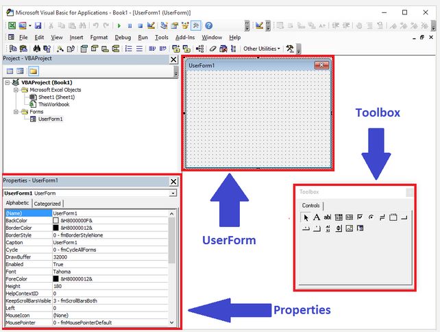

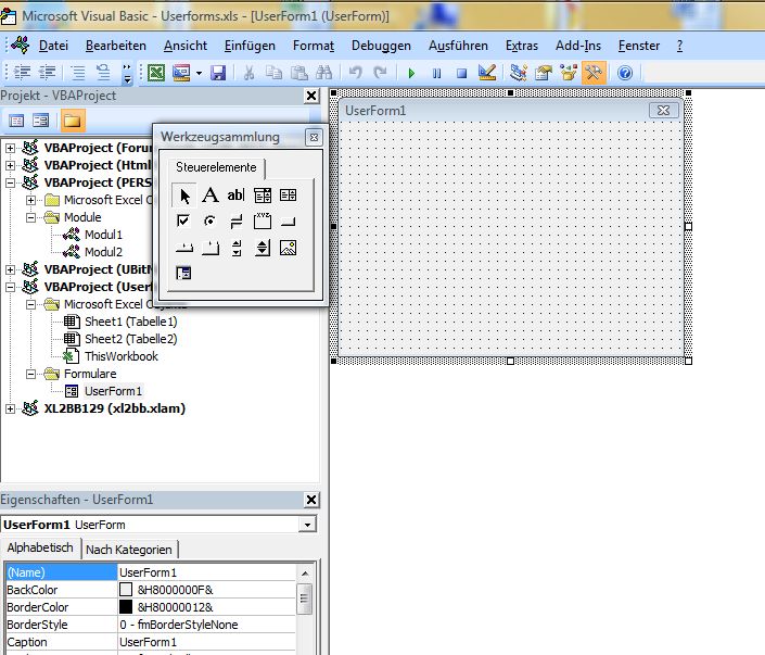

    You should then see the basic tools of
    _ a simple pin board looking box or "form", usually with the default name of UserForm1 ,( both for the main class thing and the caption name on the pin board thing top left , ( more to that later ** ) )
    , and
    _ a Toolbox dialog should also be visible. (If it’s not visible select View->Toolbox from the VB editor top ribbon menu. We use the toolbox to add controls to our UserForm.)
    The bottom left window should also now show the properties related to this UserForm

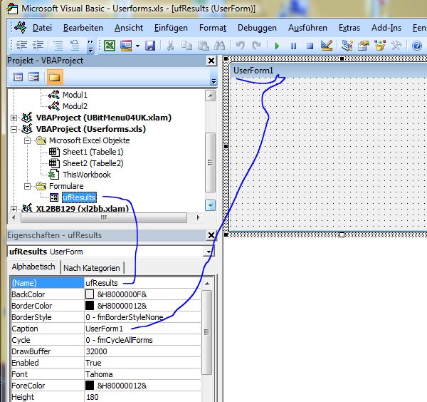

    https://i.postimg.cc/W3Fgbm8z/User-F...-VB-Editor.jpg , https://i.postimg.cc/852WFFXH/User-F...-VB-Editor.jpg
    Note that we have actually added a class, called UserForm1, and the class module that appears is part of the tools we have available for working on it.
    I will change the Name property to suit the previous discussions of this Thread, to ufResults , ** , and note that the Caption did not change,
    https://i.postimg.cc/FzN5szZd/Captio...User-Form1.jpg
    , and we will leave it like that for now, as this will help along the way, to demonstrate a quirk with UserForm Class things, which was brought out by our discussions … Unlike normal classes, UserForms are auto-instantiating, so you can simply call them by name and a new instance of the class is created. ….. as you use ufResults for the first time, a new instance of the form is created.
