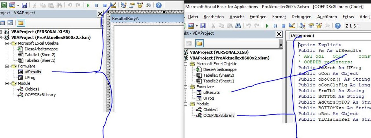

    A few random UserForm Examples,
    using coding behind Form things
    For both the main UserForm grid and anything we may, (from the tool box**) put on it, we have available coding "behind" it. This is mainly in the form of being able to tap into, that is to say, add to coding that is done when certain things take place. Usually this sort of coding is referred to as event coding.
    **Note as ever, we are not talking about anything that could be regarded as things or objects here, - even if we appear to insert from, or drag things from, to the main grid from the tool box, because these are really notes / sketches / templates from which the more substantial "thing" / object will be made by the New in the typical initial instanciating steps such as
    Rem 1 making an instance of ufResults
    Dim objufResults As ufResults
    Set objufResults = New ufResults
    We remember also the confusing complicating for the class UserForm that it is self instantiating, meaning that if we missed out that initial coding section, then it would effectively be done for us, automatically, the first time we tried to use our ufResults, pseudo like
    Dim ufResults As ufResults
    Set ufResults = New ufResults
    , meaning effectively we have an object variable which has the same name as the class from which it comes. – Very annoyingly confusing. Note, of course, that I have made the object purple just for ease of explanation. In the VB editor it will be black, and will be exactly the same word as the ufResults of the Class, as also appearing, for example, on the Class module

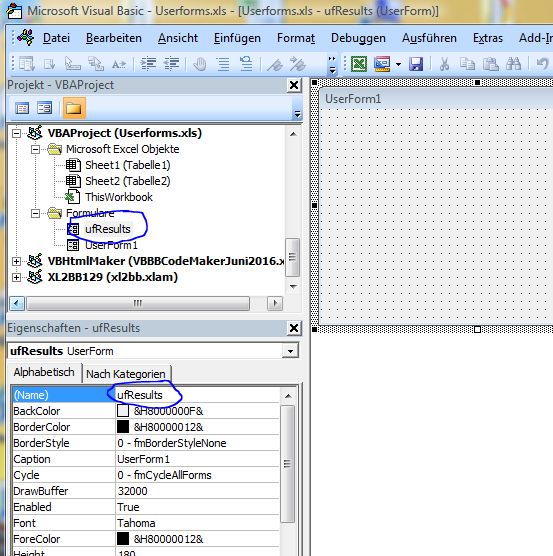

    Before dragging any template sketches from the tool box, we can take a look at what is available for coding associated primarily with the main grid, that is to say the coding "behind" the main form.
    One of the first ones that is perhaps worth an initial consideration is the Initialize Event of the VBA UserForm. To get the possibility to add to the coding for that ,
    _ Right-click on the main UserForm grid showing in the VB Editor, and select View Code from the menu.
    _ In the Dropdown list on the left above the main Window, select UserForm.
    _ This will typically give something for you to add to the UserForm_Click() event. You can ignore this.
    _ In the Dropdown list on the right above the main Window, select Initialize.
    (_ Optional: Delete the UserForm_Click() sub which appeared in step 2. The event coding for this and all the other available will be there anyway on an instantiated object , at this stage it is just a bit of worthless text ignored when the Class is used to make an actual object )
    Remember as ever, this is all just text, which will never itself be anything of significance. It is just used later by a user New, ( or the effective automatically done one )
    https://i.postimg.cc/264GZpGV/Initia...-User-Form.jpg https://i.postimg.cc/05YX6SXc/Initia...-User-Form.jpg
