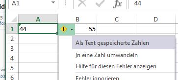

    _ The Range1 if used on the RHS is an object. Some objects have a "value" that is a text and/or number string that is returned if you try to assign that object somewhere expecting to have some text and/or number string given to it. This "value" might be that thing you see, for example, in the Watch Window.
    https://i.postimg.cc/y83k0dH3/range-...ate-Window.jpg
    Example macro in next post:
    Here a brief description of what is going on in it
    In '0a) I have found some ways empirically to get that Number held as Text thing . The thing that they have in common is putting an element of an array in a cell ( which we can’t manually do ) , and that element must be of a string type. As a Layman, I am thinking a couple of things
    _ that low level computer stuff is all about arrays of strings. I am thinking that concepts of single values, variables and the such is high level stuff that helps us Humans to interface with computers, which is what spreadsheets are about: Tables and boxes with things in them.

    Rem 1 This is the Answer, at least as far as I have got. Some objects, when assigned to somewhere or assigned to a variable, other than an Object variable, give a string. It might be this thing, it might not.
    One thing that supports the idea is that if we repeat the experiment with a multi cell range object we get nothing in the cell and see nothing in the value place in the Immediate Window
    https://i.postimg.cc/BvBQ2KRn/Multi-...ate-Window.jpg
    That perhaps makes some sense, as it could be impractical to get lots of values there. Maybe never the less they are there , which might lend some tail shirt sense to it being held in an array, of string types, although then that contradicts the fact that other objects have a string value there, but that does not appear to get put n with a warning of the Number held as Text thing
    So I am not much further with this Answer
    For the case of a formula, Excel takes a similar alignment convention, but there in not that Number held as Text warning thing . Possibly that could be because in most cases a formula would be more complicated and the result would be less ambiguous.
    But, the very last code line suggests that Excel is still knowing if it has a number stored as text, and will once again let you know at least from if you do the stuff from Rem 1

    Rem 1 ' I am not fully sure what is going on here, but I might be returning this     https://i.postimg.cc/y83k0dH3/range-...ate-Window.jpg
     Let Ws.Range("A2") = Ws.Evaluate("=IF(1=1,A1)") ' Watch : + : Ws.Evaluate("=IF(1=1,A1)") : "44"  : Variant/Object/Range : Tabelle6.RangeOnlyRHS
     Let Ws.Range("A2") = Ws.Range("=IF(1=1,A1)") '       Watch : + : Ws.Range("=IF(1=1,A1)") : "44"  : Object/Range : Tabelle6.RangeOnlyRHS
     Let Ws.Range("A2") = Ws.Range("A1")                        ' Watch : + :  Ws.Range("A1") : "44"  : Object/Range : Tabelle6.RangeOnlyRHS
     Let Ws.Range("C2") = Ws.Range("A1:B2") ' This puts nothing in the cell , and there is nothing
     '   in the Immediate window   value   place either         Watch : + : Ws.Range("A1:B2") :       : Object/Range : Tabelle6.RangeOnlyRHS         https://i.postimg.cc/BvBQ2KRn/Multi-...ate-Window.jpg
     Let Ws.Range("A3") = "=A1"  ' Put a formula into a cell with  VBA  or  manually and I think maybe Excel decides what allignment to give you.
     '                                                          Watch : + : Ws.Range("A3") : "44" : Object/Range : Tabelle6.RangeOnlyRHS
     Let Ws.Range("B3") = "=B1"  '                              Watch : + : Ws.Range("B3") : 44  : Object/Range : Tabelle6.RangeOnlyRHS
     Let Ws.Range("C4:D4").FormulaArray = "=A1:B1"
     Let Ws.Range("A4:B4") = "=A1:B1" ' Works because of   Interception and Implicit Intersection    https://www.excelfox.com/forum/showt...on-and-VLookUp
     Let Ws.Range("A5") = Ws.Range("A3") ' Watch : + : Ws.Range("A3") : "44" : Object/Range : Tabelle6.RangeOnlyRHS
