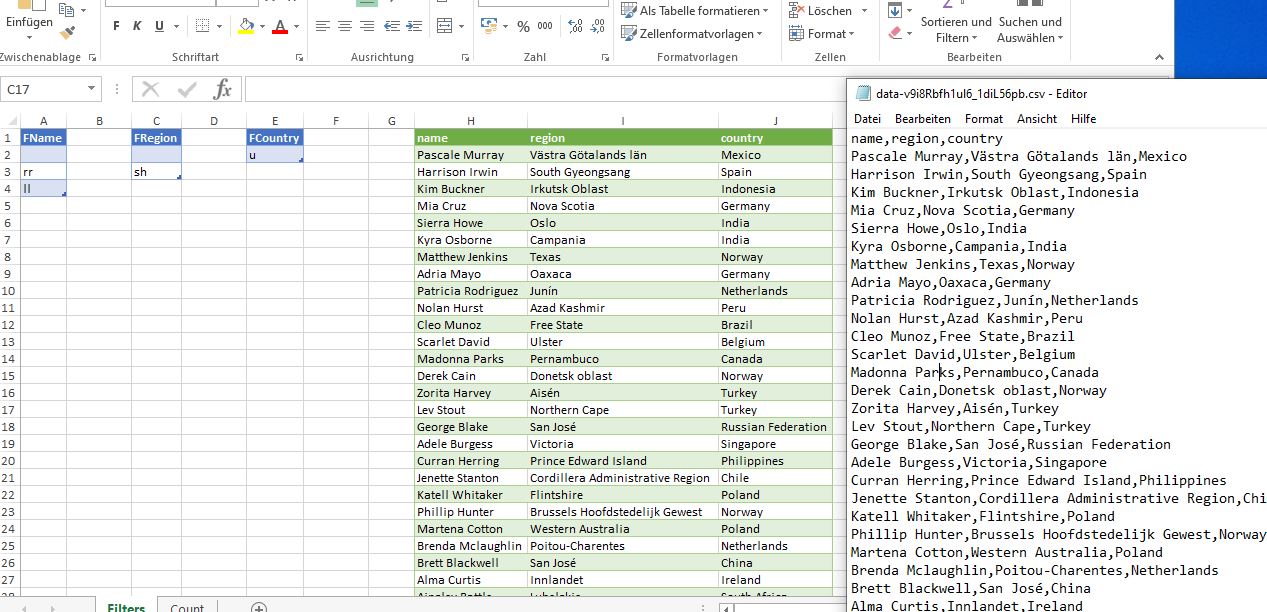

    Hi Alan, hope you are well,
    so ad rem
    I've a table (3 columns, can be more), and for this table I've three filters
    I need count rows for each filter (filtered rows and rows left after filtering), eg.
    there should be possibility resize the main table for more columns and add new tables with filters at the same time (with empty rows that will not be taken into account when counting filtered rows)
    the result should be more or less like this:
    is this possible to do it automatically after add/remove values to/from filter tables?
    I don't need filtered table but I need result table like you can see above
    thanks
    sandy

    OK, I understand a bit better what you want, but I probably do not understand fully yet.
    This is what I done so far:
    Here is a macro https://www.excelfox.com/forum/showt...ll=1#post23204
    It is also in the uploaded file. It works automatically if you type anything in column A or C or E ( or F * )
    It does not get exactly the results you want, but I don’t understand yet how you got those results: I don’t understand how you get this:

    This is what https://www.excelfox.com/forum/showt...ll=1#post23204 it does:
    If you type rr in column A , https://i.postimg.cc/s2G1SXKS/rr.jpg , it tells you automatically this

    If you tell me exactly how you get your results, then I can maybe think again, or maybe whatever….
    Sir Moderator sandy666's Avatar
    May 2018
    240
    Cool
    sure, I can tell you but you said long time ago you don't know Power Query
    here are two original files (source of data: csv file, result file: xslx file)
    path to the CSV file is: D:\test\countrows\data-v9i8Rbfh1ul6_1diL56pb.csv , if it will be different, xlsx will wont work
    whole line of source is:
    Source = Csv.Document(File.Contents("D:\test\countrows\data-v9i8Rbfh1ul6_1diL56pb.csv"),[Delimiter=",", Columns=3, Encoding=65001, QuoteStyle=QuoteStyle.None]),
    if you extract zip file and move countrows folder to D:\test\ - it should work

    (Using Excel 2013). I think I did what you said
    Then I opened the Excel file. ... but, I don’t see anything new
    ( The csv file is just the table https://i.postimg.cc/PJBXMWqj/csv-Fi...just-table.jpg )
    For example:
    How can I have Region filter 72 left / filtered 8 when in table column I ( region ) , I have 100 things to start with??? 72+8 is not 100??
    I got an idea… let me light a candle in my thinking head, and drink some SchlappenBier medicine:
    Is this what you mean:
    First I filter by Fname using the whole table and this gets me some things “Filtered”. “Filtered” means this: If I filter, for example, by Fname rr then these 6 lines are removed from the table

    each filter filters the values of the remaining rows and not all, only the first filter filters the total (100).
    you can test it using only the last filter with the rest left blank (don't know if it will work on xl2013)
    hope it's clear now

    you insisted on showing the filter results and I don't want it, maybe this description will be better: filter1 - show count filtered1 rows AND count left rows after filter1, then filter2 shows count rows from left rows after filter1 - it will be count2 filtered and left2 after filter2 , and etc
