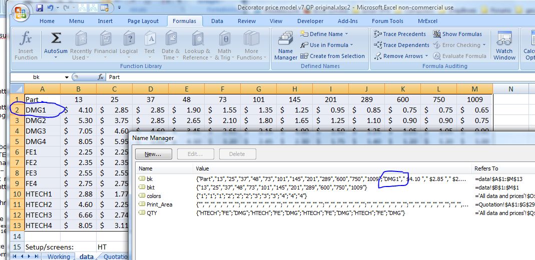

    Hi there
    I don’t understand?
    I thought this was table bk ?
    https://postimg.cc/mthjqfLQ https://i.postimg.cc/Hs9NrdFP/bk-Table-data-A1-M13.jpg
    What am I missing?

    =VLOOKUP(F$26,{"Part",13,25,37,48,73,101,145,201,2 89,600,750,1009;"DMG1",4.1,2.85,2.85,1.9,1.55,1.35 ,1.25,0.95,0.85,0.75,0.75,0.65;"DMG2",5.3,3.75,2.8 5,2.65,2.1,1.8,1.65,1.25,1.1,0.9,0.9,0.75;"DMG3",7 .05,4.6,4.6,3.45,2.65,2.15,1.9,1.5,1.25,1.05,1.05, 0.9;"DMG4",8.05,5.95,5.95,4.1,3.2,2.45,2.3,1.75,1. 4,1.2,1.2,1;"FE1",2.25,2.25,1.6,1.6,1.4,1.4,1.2,1. 2,1,0.95,0.95,0.9;"FE2",2.35,2.35,1.8,1.8,1.55,1.5 5,1.4,1.4,1.05,1,1,0.95;"FE3",2.55,2.55,2,2,1.7,1. 7,1.6,1.6,1.1,1.05,1.05,1;"FE4",2.75,2.75,2.2,2.2, 1.85,1.85,1.75,1.75,1.15,1.1,1.1,1.05;"HTECH1",2.8 8,1.77,1.77,1.77,1.14,1.14,0.91,0.91,0.78,0.66,0.6 ,0.55;"HTECH2",4.6,2.25,2.25,2.25,1.43,1.43,1.28,1 .28,1.02,0.84,0.76,0.69;"HTECH3",6.66,2.74,2.74,2. 21,1.71,1.62,1.62,1.62,1.27,1.02,0.93,0.84;"HTECH4 ",8.05,3.11,3.11,2.5,2.04,2.04,1.98,1.98,1.51,1.2, 1.09,0.98},6)
    where is DMG1 on index = 6 ?
    I see DMG1 on index = 14

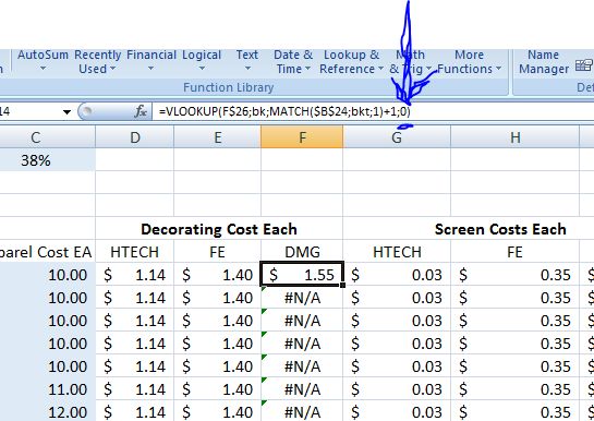

    with formula =VLOOKUP(F$26,bk,MATCH($B$24,bkt,1)+1,0) value $1.55 is returned and so on
    OP just forgot comma on the end or define last argument 0, VLOOKUP(F$26,bk,MATCH($B$24,bkt,1)+1,) so he need to learn how to use VLOOKUP function
    VLOOKUP require all arguments, even if last argument is omitted there should be defined place for it after last comma
    I suggest to use INDEX / MATCH instead of VLOOKUP
    ..just forgot comma on the end or define last argument 0, VLOOKUP(F$26,bk,MATCH($B$24,bkt,1)+1,) so he need to learn how to use VLOOKUP function
    https://i.postimg.cc/15VpN7Hj/ThatsIt.jpg
    ( I thought I had checked that, but missed something somewhere, I don’t know why I missed that, maybe I think also I need to learn how to use VLoopUp properly! )
    But just out of interests, and for me to learn better, 2 things you said I don’t understand……
    _1
    Quote Originally Posted by sandy666 View Post
    Why you say this? DMG1 is LookUp_Value so is in column A ( index 1 )
    What am I missing again?
    _2
    Why you say this? There is no index 14? Index 14 would be column N, but column N is not in range A1:M13 ( maximum column_index for table_array range A1:M13 is 13 )
    Can you help me understand what I am missing, Thx
    ( I also do not understand why it works sometimes? )
    bk range lookup
    {"Part",13,25,37,48,73,101,145,201,2 89,600,750,1009;"DMG1",4.1,2.85,2.85,1.9,1.55,1.35 ,1.25,0.95,0.85,0.75,0.75,0.65;"DMG2",5.3,3.75,2.8 5,2.65,2.1,1.8,1.65,1.25,1.1,0.9,0.9,0.75;"DMG3",7 .05,4.6,4.6,3.45,2.65,2.15,1.9,1.5,1.25,1.05,1.05, 0.9;"DMG4",8.05,5.95,5.95,4.1,3.2,2.45,2.3,1.75,1. 4,1.2,1.2,1;"FE1",2.25,2.25,1.6,1.6,1.4,1.4,1.2,1. 2,1,0.95,0.95,0.9;"FE2",2.35,2.35,1.8,1.8,1.55,1.5 5,1.4,1.4,1.05,1,1,0.95;"FE3",2.55,2.55,2,2,1.7,1. 7,1.6,1.6,1.1,1.05,1.05,1;"FE4",2.75,2.75,2.2,2.2, 1.85,1.85,1.75,1.75,1.15,1.1,1.1,1.05;"HTECH1",2.8 8,1.77,1.77,1.77,1.14,1.14,0.91,0.91,0.78,0.66,0.6 ,0.55;"HTECH2",4.6,2.25,2.25,2.25,1.43,1.43,1.28,1 .28,1.02,0.84,0.76,0.69;"HTECH3",6.66,2.74,2.74,2. 21,1.71,1.62,1.62,1.62,1.27,1.02,0.93,0.84;"HTECH4 ",8.05,3.11,3.11,2.5,2.04,2.04,1.98,1.98,1.51, 1.2, 1.09,0.98} with index for DMG1 = 14 (in range lookup)
    MATCH is a column index
    too many indexes but I'm an old idiot and mixed indexes
    anyway problem is solved by last argument 0 (-1, 1) or defined (mandatory) place for last argument after comma
    ...anyway problem is solved by last argument 0 (-1, 1) ...
    For Match is, I think, last argument 0 or 1 or -1
    but for VLookUp, last argument is 0 or 1 ( or False or True )
