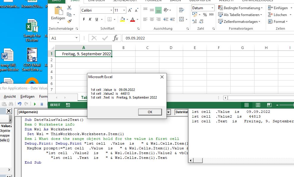

    As Example:
    In the attached file, I have a date in the first cell.
    In that attached file is also the macro shown below. If you run that macro, it should give you three different values. Those three different values are the three value properties of the range object of the first cell, .Text , .Value , .Value2
    You will not get exactly the same results as me for .Value and .Text , because the value is influenced by your internal settings and your Land version.
    The value for .Value2 should be exactly the same as what I get, because: For dates in Excel, Excel holds as the most low level value, a number which starts at 1 for the date of January 1, 1900. For the date which I have in the first cell ( 9th September, 2022) Excel has the internal value of 44813.

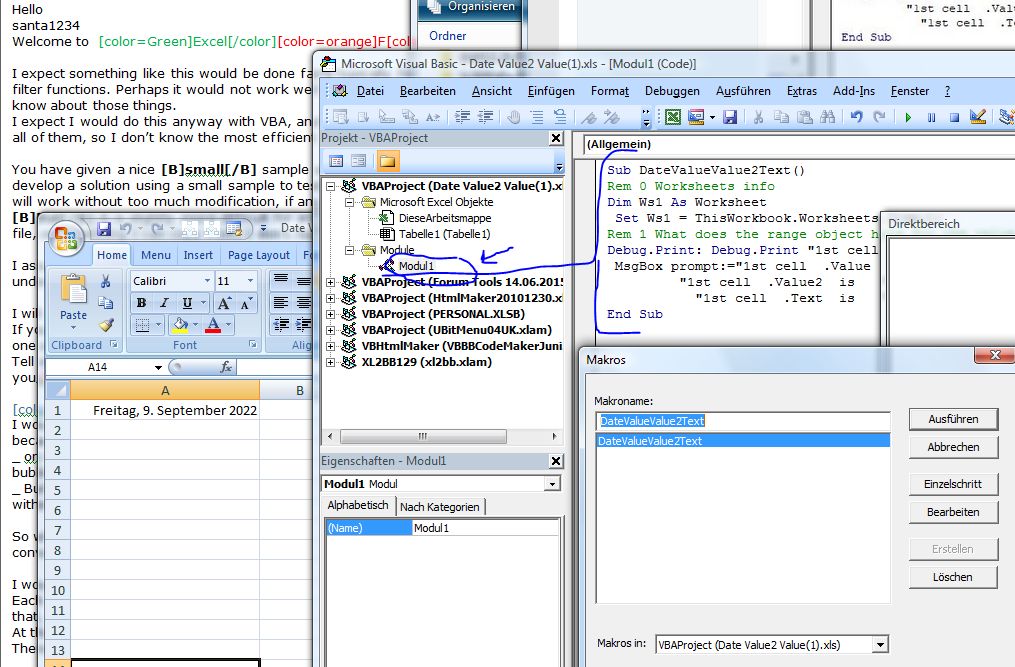

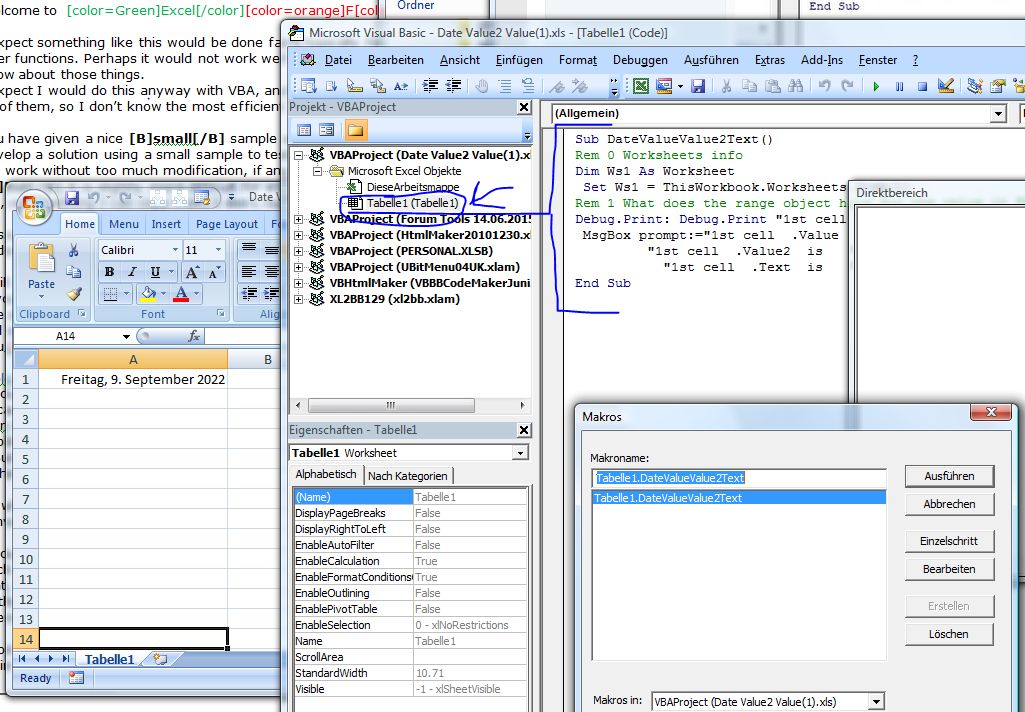

    ** By the way, the macro was in that file, but you may not have seen it. – To explain:
    I have an annoying personal habit of putting macros in a worksheet object code module: A worksheet object code module’s main purpose is to let us have access to Event codings associated with a worksheet. But we can also put normal macros in them, and usually they work normally.

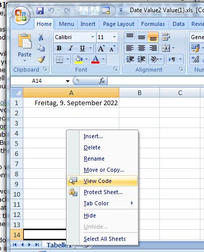

    To see the coding in a worksheets object code module, either
    _ Right click on the worksheet tab and select View Code, ( that will open the VB Editor): https://i.postimg.cc/13YZRyQr/Right-...-Show-Code.jpg

    It is not normal professional practice to use a worksheet object code module for normal macros. It is just my personal choice. (I am not an educated computer professional. Bear that in mind when taking any advice from me. Lol!)
    In the file attached to this post, Date Value2 Value(1).xls , I also added a normal code module and put the macro in that as well: https://i.postimg.cc/g0CFR4rw/Normal...m-VBEditor.jpg

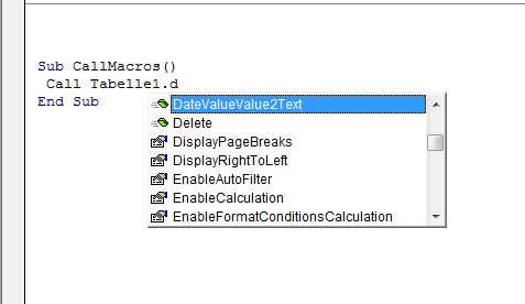

    ( Just for completeness, to clarify all that, I added another macro, Sub CallMacros() . That macro, (which is in the normal code module, but could also be out in a worksheet object code module, ) , will call both macros.
    Sub CallMacros() ' https://excelfox.com/forum/showthread.php/2813-CORRECT-WAY-TO-FILL-A-TEXTBOX?p=16692&viewfull=1#post16692
     Call DateValueValue2Text '           Excel will look for this macro in the normal code modules.  Usually it will find it, but you are relying on Excel geussing correctly!
     Call Tabelle1.DateValueValue2Text  ' You are telling Excel exactly where your macro is
     Call Modul1.DateValueValue2Text    ' You are telling Excel exactly where your macro is
    As you see, we should always explicitly refer to where the macro is, via Tabelle1. or Modul1.
    https://i.postimg.cc/rwpkLKvp/Macro-...-Is-Method.jpg https://i.postimg.cc/Dy6TDqpD/Macro-...-Is-Method.jpg
    I personally always include the full explicit referencing, but most people don’t. If you miss that extra Tabelle1. or Modul1. out the then mostly it will always work OK as Excel will assume you have the macro as Public in a normal code module, and it will find the right one.
