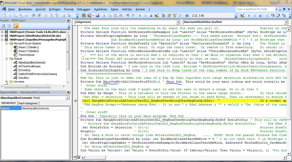

    Click anywhere in Private Sub MainSubWithAllOtherStuffInIt(),
    Press continually the F8 key to step through line by line.
    https://i.postimg.cc/SKZ5jnXb/Step-d...n-main-Sub.jpg

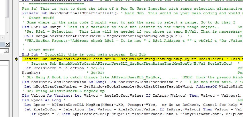

    We pass Dim RSel As Range , without hanging there, (as declare type code lines such as that are pseudo already done in VBA coding). It is necessary to have been done, because we pass that range variable ( which contains a pointer to the range object) ByRef. (That "by referable" , ByRef , to the variable type passing is determined by the signature line in the next routine, Private Sub HangAHookToCatchAPIssinUserDLL_MsgBoxThenBringThat MsgBoxUp(ByRef RcelsToYou) )
    Passing Call HangAHookToCatchAPIssinUserDLL_MsgBoxThenBringThat MsgBoxUp(RSel) , takes us, as we typically expect in VBA, into Private Sub HangAHookToCatchAPIssinUserDLL_MsgBoxThenBringThat MsgBoxUp(ByRef RcelsToYou) '
    https://i.postimg.cc/L6zWjQ4C/passin...cels-To-Yo.jpg
    passing into Private Sub HangAHookToCatchAPIssinUserDLL_MsgBoxThenBringThatMsgBoxUp(ByRef Rcels.jpg
    Passing Set RcelsToYou = Selection effectively makes the variable in the main Sub, RSel point to the selected range in the active spreadsheet ( Active Cell :- http://www.eileenslounge.com/viewtop...2b3811#p313746

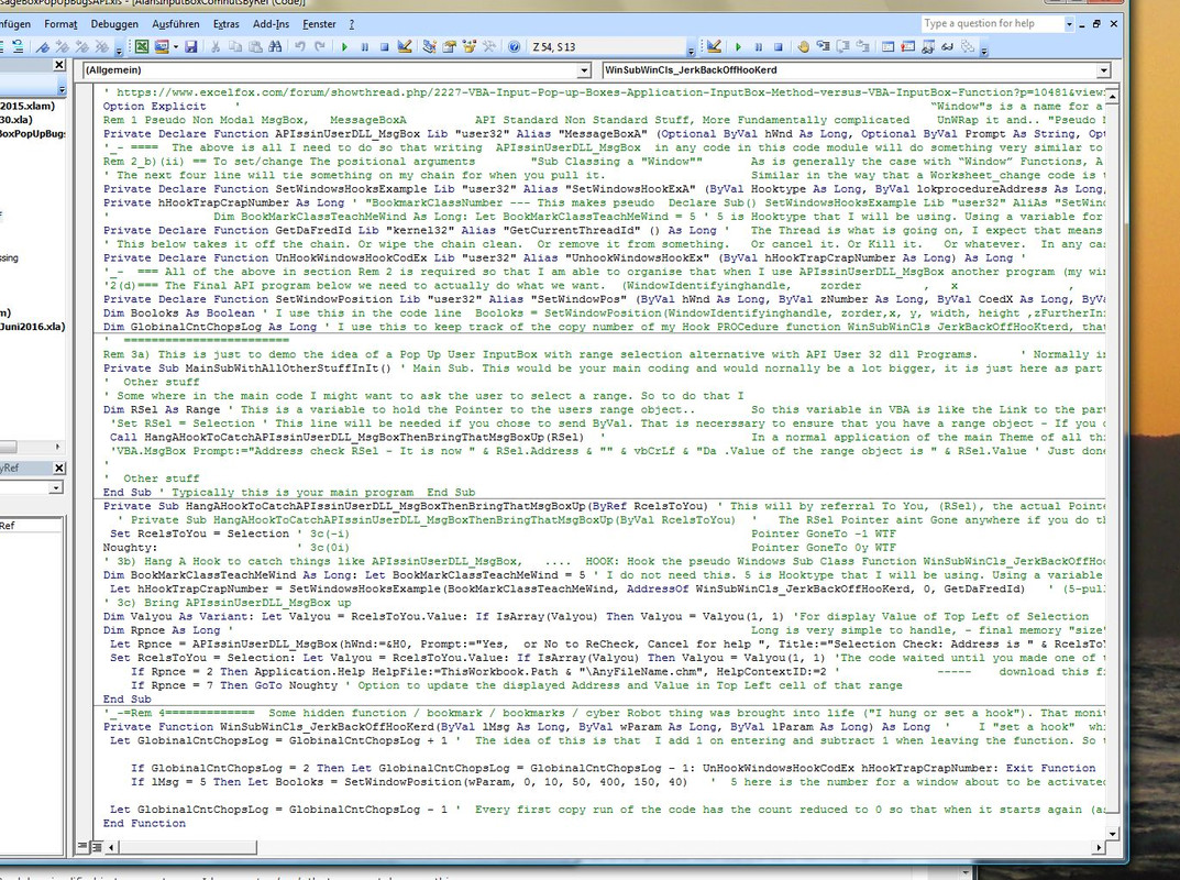

    We now pass Let Rpnce = APIssinUserDLL_MsgBox( hWnd:=&H0, Prompt:="Yes, or No to ReCheck, Cancel for help ", Title:="Selection Check: Address is " & RcelsToYou.Address & " Value is """ & Valyou & """", Buts:=vbYesNoCancel ) ' . Ordinarily in a more simple use of the non modal MessageBoxA, this would bring up our Message Box pop up. But that does not immediately happen because we set a hook which amongst other things catches things that may go on when the dll coding set of by MessageBoxA, runs. (More technically speaking, I have done a bit of sub classing or made a form of custom dll of my own).
    My hook has been pulled/aroused, which sets off Function WinSubWinCls_JerkBackOffHooKerd( ByVal lMsg As Long, ByVal wParam As Long, ByVal lParam As Long ) As Long '
    https://i.postimg.cc/TP6d9sCY/passin...-As-Long-B.jpg
    passing into Function WinSubWinCls_JerkBackOffHooKerd(ByVal lMsg As Long, ByVal wParam As Lon.jpg
    The main purpose of Function WinSubWinCls_JerkBackOffHooKerd( [ color=Blue]ByVal[/color] lMsg As Long, ByVal wParam As Long, ByVal lParam As Long ) As Long ' can in simple terms be regarded as modifying some dimensions of a window that is opening. In other words we caught our MessageBoxA opening, and mess with some of its default dimensions. That is what these figures are about (wParam, 0, 10, 50, 400, 150, 40)
    There are a couple of snags, _(a) and _(b), one expected, _(b), and one that only I have noticed, _(a).
    _(a) When I do the code line SetWindowPosition(wParam, 0, 10, 50, 400, 150, 40) , an unexpected/ unwanted occurrence is that the function is set off again, that is to say a copy of it starts before the initial copy finishes. This is allowed in VBA coding and is basically the phenomena known as recursion. (Often this can go on almost for ever, before the famous stack overflow error occurs when your computer can no longer cope with storing things related to the many copies that are started but never finished. Strangely in this case, it seems to be stopped at a certain number of copies, so it is not such a terminal problem. Never the less it is undesirable. So I have a global variable, GlobinalCntChopsLog which has the effect of keeping track of the copy number currently running. (This is achieved by increasing it by 1 when a copy starts, and decreasing it by 1 when the copy finishes.
    So the second line in the, If GlobinalCntChopsLog = 2 Then …………. effectively allows us to do the necessary terminations, when the function has done once already what we want, which is the dimension related stuff, (wParam, 0, 10, 50, 400, 150, 40)
    _(b) Not all things that are caught by the hook and so set off this function are the thing which allow the (wParam, 0, 10, 50, 400, 150, 40) to do what we want. The If lMsg = 5 Then makes the correct event. (It is a bit too subtle point for this simplified explanation, but 5 coming into the function via BookMarkClassTeachMeWind from the previous routine does not always follow that a 5 would be used here. )
    We may have got a bit lost in the trees here. So lets us go back a bit to ………My hook has been pulled/aroused, which sets off Function WinSubWinCls_JerkBackOffHooKerd( ByVal lMsg As Long, ByVal wParam As Long, ByVal lParam As Long ) As Long '
    https://i.postimg.cc/TP6d9sCY/passin...-As-Long-B.jpg ……
    If you step through, you will see that the function is done a few times. This is perhaps because we are either catching many things or, as the more detailed explanations suggest, we may actually have a few hooks catching things. They do not all meet the requirement of the If lMsg = 5 Then ….. so not much is done. (In these repeated runs of the function, we ended the functions normally, so GlobinalCntChopsLog is 1, so we do not encounter the recursion phenomena discussed )
    Eventually after about 6 goes, the If lMsg = 5 Then ….. criteria is satisfied. The main …. (wParam, 0, 10, 50, 400, 150, 40)…. is then done, but you will notice that doing that seems to set off the function again, but if you continue to step through and hover over the variable GlobinalCntChopsLog, you will see that it is 2, so we have detected this, https://i.postimg.cc/DwRnkxV9/Hover-...og-is-at-2.jpg Hover over to see GlobinalCntChopsLog is at 2.JPG
    By virtue of that 2, the termination of the current running function is done with a necessary removal or the hook or hooks, or similar done by the UnHookWindowsHookCodEx hHookTrapCrapNumber
    We return then into the previous function, Sub HangAHookToCatchAPIssinUserDLL_MsgBoxThenBringThat MsgBoxUp(ByRef RcelsToYou) ' , which initially has the effect of the line which triggered Function WinSubWinCls_JerkBackOffHooKerd( ByVal lMsg As Long, ByVal wParam As Long, ByVal lParam As Long ) As Long completing ,which attempted to, and so does now , bring up the pop up. So it should then, indeed, pop up https://i.postimg.cc/s2hcw4Rf/Popped-up.jpg Popped up.jpg
    After making a selection, you will come to the next line in the main Sub of Set RcelsToYou = Selection …………….. https://i.postimg.cc/DZTbKt8D/Completed-pop-up.jpg Completed pop up.JPG
    The rest is fairly self explanatory:- Basically once you are happy that you have made the correct range selection, this routine, Sub HangAHookToCatchAPIssinUserDLL_MsgBoxThenBringThat MsgBoxUp(ByRef RcelsToYou) , ends and you are back into the main coding, and have the range object of your choice in the variable RSel

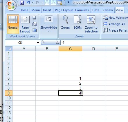

    A run of Private Sub MainSubWithAllOtherStuffInIt()
    We need to make a minor change, temporarily, so as to be able to run the main macro from the spreadsheet: Change the Private to Public
    https://i.postimg.cc/rwRwrPxm/Change...emporarily.jpg
    Now, we can close the VBEditor and concentrate on the spreadsheet.
    Select some arbitrary cell with any value in it: https://i.postimg.cc/hG94CQCR/Select...alue-in-it.jpg

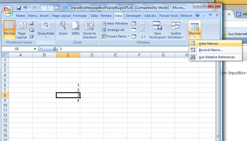

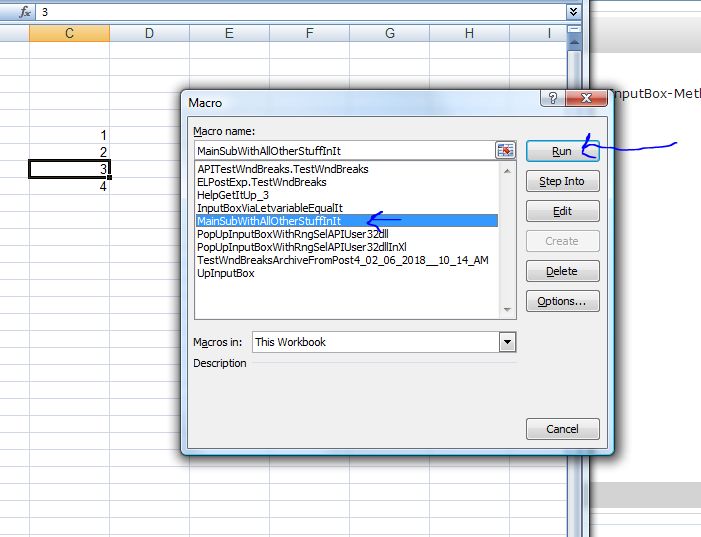

    Take the - View - Macros - ribbon route,
    https://i.postimg.cc/3wMJCFFZ/View-t...via-ribbon.jpg
    , ( or the short cut key combination of holding the Alt key then selecting key F8 ) , to get the macro dialogue pop up

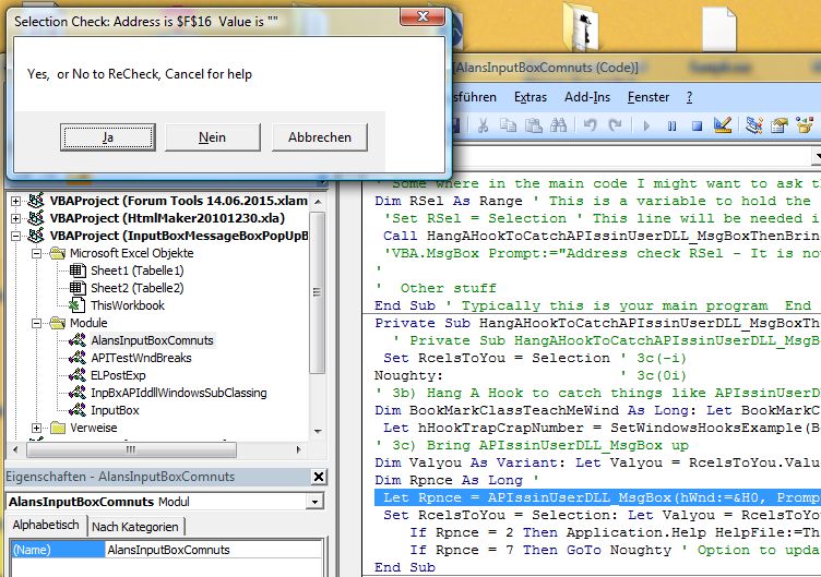

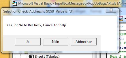

    Select Sub MainSubWithAllOtherStuffInIt() and then the Run Button: https://i.postimg.cc/PrRqNjL9/Run-Su...tuff-In-It.jpg

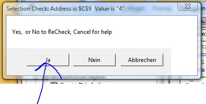

    The message box pop up should now prompt you for for a response: https://i.postimg.cc/bNJJzJv1/Prompted-for-answer.jpg
    Let us say , just as a demonstration example , that you did not want that cell that is selected. So, ignore the prompt initially, and make another selection: https://i.postimg.cc/gc4jFRGY/Make-a...-selection.jpg (This should be possible, since, unlike the standard VBA message box pop up, our pop up is non modal, which means you can still select things whilst the pop up is showing)

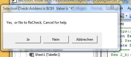

    The message box pop up will not have changed as a result od you making a new selection, , and will it still be suggesting / asking you if you wanted the previous selection. So answer No n https://i.postimg.cc/MHsp7k9c/Answer-No.jpg

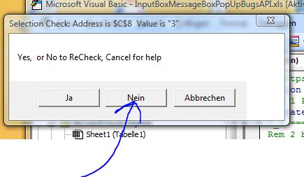

    The message box pop up should then re appear almost immediately indicating that you have the new selection:
    https://i.postimg.cc/0j5NK50R/Messag...-selection.jpg
    So answer Yes https://i.postimg.cc/Jn5nhHJ5/Answer-Yes.jpg

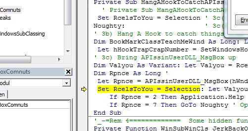

    We have filled/assigned the variable RSel to the current selection ** in the main sub to the existing selection, with the first extra line - Set RSel = Selection - added to aid in the explanation, and we do this just before the coding goes off into the API related things.
    The first thing that then is done in the initial API coding is that a code line - Set RcelsToYou = Selection - does effectively very similar to our first extra code line. However, the main point that will be emphasised many times in such explanations, is that the second time we are doing something important a bit different: RcelsToYou is no longer referring to the variable RSel. It will at this point, point to the same range object assigned to RSel, because it is a copy of the pointer. But as we proceed through selections via our pop up in the course of running normally all the coding, we will no longer be actually changing the range object to which RSel refers/points to.
    Just before the end of the main coding , the other extra code line - RSel.Select - will now select our very first selection, regardless of any selections we made during the course of our pop up in the course of running normally all the coding.
    The end result rather goes against the main purpose of this thread, which is to have the range object referred to/ pointed to by the variable RSel changed as a result of a selection. But it emphasises the need to have ByRef in the coding to achieve our main original requirement

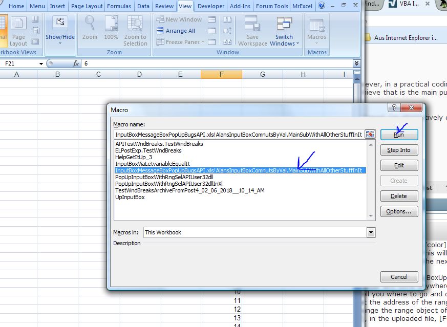

    Working example for the ByVal case
    We will do a practical example that helps show the important difference between the ByVal and ByRef codings. (Although it should be noted that there are many simpler ways to achiever the same without the complicated API stuff)
    We will use exactly the same demo coding as in the last post The full coding is in the code module, AlansInputBoxComnutsByVal , in the uploaded file, InputBoxMessageBoxPopUpBugsAPI.xls
    I need to make the same minor temporary change to the main coding, just as I did in the last post. As previously, this is just so that I can access the macro from the spreadsheet: Please change the Private to Public in the main.
    https://i.postimg.cc/J08KY7rK/Change...emporarily.jpg
    We can close not the VBEditor, and concentrate on the spreadsheet.

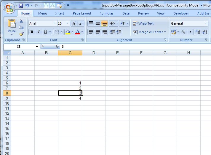

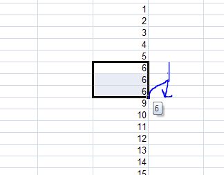

    Lets say we have a long list, which in the practice could be very long. Lets say I want to work down the list , changing just some cell values.
    Select Sub MainSubWithAllOtherStuffInIt() and then the Run Button: https://i.postimg.cc/LsrxfBGc/Run-Su...tuff-In-It.jpg
    Select a cell towards the top of the list,
    https://i.postimg.cc/ydcvT3Hk/Select...f-the-list.jpg
    , make a change, such as dragging a value down.
    https://i.postimg.cc/rpdhKYZG/Make-s...value-down.jpg
    Make some similar change a bit further down, such as dragging a value up.
    https://i.postimg.cc/QdY4Nrmx/Select...ue-details.jpg
    If now you select No on the message box pop up, then your top left selection value will be shown, as well as the range selection address.

    API stuff tidily away in separate module
    So far we have had all the 4 main coding sections in one code module. This helped to keep things fairly compact for the explanations, especially the code walk through which went neatly from the main sub down to the other two needed routines, then back to finish at the main sub.
    It would also be Ok in a practical usage with a much larger main sub to do this, although then the main sub might be brought down to be the last, just for the sake of tidiness to keep most of the extra APIU stuff together at the top.
    Another possibility would be to keep most of the API stuff in a separate module.
    Doing this requires only 2 minor modifications.
    _ The main sub will of course be removed to another code module
    _ The only other modification is that the Called routine ,
    , will need to be made Public or else it cannot be Called from outside the module in which it is in
    Public Sub HangAHookToCatchAPIssinUserDLL_MsgBoxThenBringThat MsgBoxUp(ByRef RcelsToYou)
    The other things are only referenced from within the module, so they can be left Private, which is good practice to do so as to give better flexibility to naming other things outside the module
    Since we have many comments and detailed explanations already, I will also remove the comments for clarity for this iteration of the coding development. As mentioned, the detailed commented codings are netter suited for the all in one code module, such as the module AlansInputBoxComnutsByRef
    I will make a new code module, for the API stuff, called InpBxAPIddllWindowsSubClassing, and these will be the three coding sections in it
    Private Declare Function APIssinUserDLL_MsgBox Lib "user32" Alias "MessageBoxA" (Optional ByVal hWnd As Long, Optional ByVal Prompt As String, Optional ByVal Title As String, Optional ByVal Buts As Long) As Long
    Private Declare Function SetWindowsHooksExample Lib "user32" Alias "SetWindowsHookExA" (ByVal Hooktype As Long, ByVal lokprocedureAddress As Long, Optional ByVal hmod As Long, Optional ByVal DaFredId As Long) As Long
    Private hHookTrapCrapNumber As Long
    Private Declare Function GetDaFredId Lib "kernel32" Alias "GetCurrentThreadId" () As Long
    Private Declare Function UnHookWindowsHookCodEx Lib "user32" Alias "UnhookWindowsHookEx" (ByVal hHookTrapCrapNumber As Long) As Long
    Private Declare Function SetWindowPosition Lib "user32" Alias "SetWindowPos" (ByVal hWnd As Long, ByVal zNumber As Long, ByVal CoedX As Long, ByVal CoedY As Long, ByVal xPiXel As Long, ByVal yPiYel As Long, ByVal wFlags As Long) As Long
    Dim Booloks As Boolean
    Dim GlobinalCntChopsLog As Long
    '____________________________________________________________________________________
    Public Sub HangAHookToCatchAPIssinUserDLL_MsgBoxThenBringThatMsgBoxUp(ByRef RcelsToYou)
    Noughty:
    Dim BookMarkClassTeachMeWind As Long: Let BookMarkClassTeachMeWind = 5
     Let hHookTrapCrapNumber = SetWindowsHooksExample(BookMarkClassTeachMeWind, AddressOf WinSubWinCls_JerkBackOffHooKerd, 0, GetDaFredId)
    Dim Valyou As Variant: Let Valyou = RcelsToYou.Value: If IsArray(Valyou) Then Valyou = Valyou(1, 1)
    Dim Rpnce As Long
     Let Rpnce = APIssinUserDLL_MsgBox(hWnd:=&H0, Prompt:="Yes,  or No to ReCheck, Cancel for help ", Title:="Selection Check: Address is " & RcelsToYou.Address & "  Value is """ & Valyou & """", Buts:=vbYesNoCancel)
     Set RcelsToYou = Selection: Let Valyou = RcelsToYou.Value: If IsArray(Valyou) Then Valyou = Valyou(1, 1)
        If Rpnce = 2 Then Application.Help HelpFile:=ThisWorkbook.Path & "\AnyFileName.chm", HelpContextID:=2
        If Rpnce = 7 Then GoTo Noughty
    Private Function WinSubWinCls_JerkBackOffHooKerd(ByVal lMsg As Long, ByVal wParam As Long, ByVal lParam As Long) As Long
     Let GlobinalCntChopsLog = GlobinalCntChopsLog + 1
        If GlobinalCntChopsLog = 2 Then Let GlobinalCntChopsLog = GlobinalCntChopsLog - 1: UnHookWindowsHookCodEx hHookTrapCrapNumber: Exit Function
        If lMsg = 5 Then Let Booloks = SetWindowPosition(wParam, 0, 10, 50, 400, 150, 40)
    In any code module requiring the pop up, these would be the required code lines
    Dim RSel As Range ' This is a variable to hold the Pointer to the users range object..        So this variable in VBA is like the Link to the part of a URL string reducing size site where a few things about the actual Final site is informed about. This area in that site, like a pigeon Hole to which the variable refers, ( the "pigeon hole" location address, and all its contents would be defined as the "Pointer". Amongst other things it has a link, a "Pointing part", pointing to actually where all the stuff is
     Call HangAHookToCatchAPIssinUserDLL_MsgBoxThenBringThatMsgBoxUp(RSel)  '                     In a normal application of the main Theme of all this, this would be the main code line you use to cause a the "Pop Up User pseudo InputBox with range selection alternative with API User 32 dll Programs"
