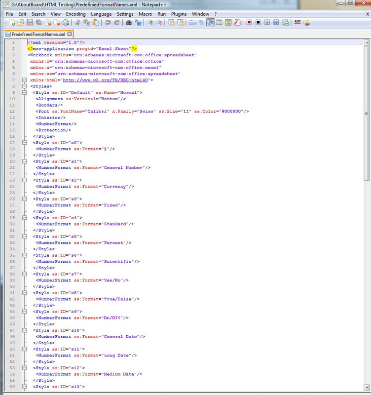

    Some of Andreas stuff
    HTML Code:
    <?xml version="1.0"?>
    <?mso-application progid="Excel.Sheet"?>
    <Workbook xmlns="urn:schemas-microsoft-com:office:spreadsheet"
     xmlns:o="urn:schemas-microsoft-com:office:office"
     xmlns:x="urn:schemas-microsoft-com:office:excel"
     xmlns:ss="urn:schemas-microsoft-com:office:spreadsheet"
     xmlns:html="http://www.w3.org/TR/REC-html40">
     <Styles>
      <Style ss:ID="Default" ss:Name="Normal">
       <Alignment ss:Vertical="Bottom"/>
       <Borders/>
       <Font ss:FontName="Calibri" x:Family="Swiss" ss:Size="11" ss:Color="#000000"/>
       <Interior/>
       <NumberFormat/>
       <Protection/>
      </Style>
      <Style ss:ID="s0">
       <NumberFormat ss:Format="@"/>
      </Style>
      <Style ss:ID="s1">
       <NumberFormat ss:Format="General Number"/>
      </Style>
      <Style ss:ID="s2">
       <NumberFormat ss:Format="Currency"/>
      </Style>
      <Style ss:ID="s3">
       <NumberFormat ss:Format="Fixed"/>
      </Style>
      <Style ss:ID="s4">
       <NumberFormat ss:Format="Standard"/>

    In Notepad ++
