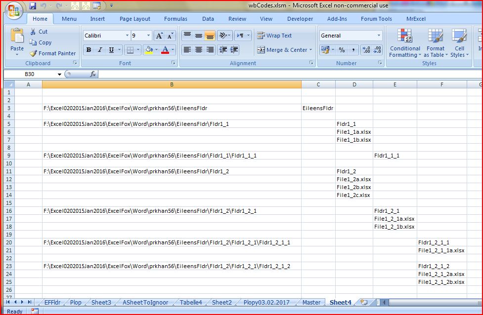

    And i initially Wrote the codes to give out an explorer type output to a sheet. This shows then the Root type plan of all Files, and Folders ,within a main Folder. ( In this simplified version it gives the Output to the current ActiveSheet)
    So it is an extended version of what the snb code gives in the immediate Window. But here it is printing to the Active Sheet rather than the Immediate Window ( I wish i knew how to do a snb version, but I expect it is beyond the limit of a “one liner” anyway... )
    When you run the code it asks you for the Folder you want to look at.

    (-.. and the typical output it gives here
    Excel Help Forum
    _......)

    Run the macro, Sub VBADoStuffInFoldersInFolderRecursion() 'Main routine to "Call" the first copy of the second routine, VBALoopThroughEachFolderAndItsFile( ( make sure you have the new made sheet active )
    The results match those given in the previous posts: Example results.jpg
