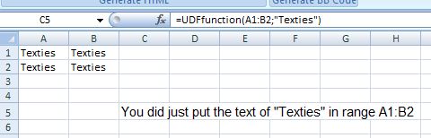

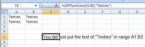

Simplest Working Example:
The simplest example is something like the following:
Copy both procedures to a normal code module , …_
' Paste both procedures in a normal code module, then type =ChangeNextCell() in any cell followed by Enter
Function ChangeNextCell()
' Call NextCell ' This wont work. We will be on the same dependancy in the called procedure and cell dependancies are already calculated so attempts to access cells will be screwed up
Evaluate "NextCell()" ' The dependance tree is recalculated for the procedure NextCell() which is excecuted from a copy of the procedure not dependant on the spreadsheet update cycle in progress for the excecution of the function ChangeNextCell()
Sub NextCell()
ActiveCell.Offset(0, 1).Value = "Next cell." ' Excel has a memory of the last Active Cell and does not rely on dependance to the spreadsheet for this macro to run

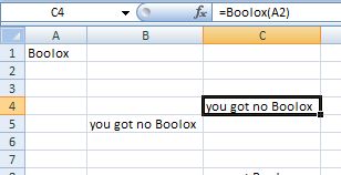

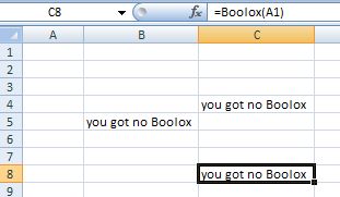

_... then type in any cell the function _ =ChangeNextCell() _ then _ Enter
ChangeNextCell.JPG : http://i.imgur.com/nqHHEfb.jpg https://imgur.com/nqHHEfb
https://i.imgur.com/nqHHEfb.jpg
ChangeNext Cell.JPG : http://i.imgur.com/iAQFUrj.jpg https://imgur.com/iAQFUrj
https://i.imgur.com/iAQFUrj.jpg
Change Next Cell.JPG : http://i.imgur.com/V7Lowxp.jpg https://imgur.com/V7Lowxp
https://i.imgur.com/V7Lowxp.jpg
In the next post some attempt to examine what’s going on. It is not complete; I may need to come back again on this one

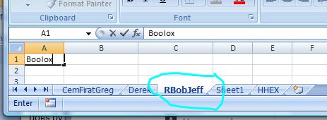

You need all the coding, and one typical convenient place to keep it is in the workbook where you are wanting to use the “it”. “It” being the formula and necessarily the coding which it won’t work without
To keep it simple, the coding needs to go in what we call a normal code module.
Although not always necessarily necessary, for the purposes of the demo, you need to confine yourself to using the worksheet named "RBobJeff" in the uploaded file, ( Or name a worksheet in another workbook "RBobJeff", and do the demonstration in that )
Now, in the first cell, A1, I have written Boolox, ( or if you are using your own file, then write Boolox in the first cell, A1 )

For examples
For example, after writing in cell C4 =Boolox(A2) , you should see
https://i.postimg.cc/1RYQzkyN/you-got-no-boolox.jpg
For example, after writing in cell C8 =Boolox(A1) , you should see
https://i.postimg.cc/05HsNT9K/you-got-boolox.jpg
