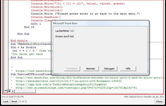

https://i.postimg.cc/L5tmj8Jc/VBA-De...or-Handler.jpg https://i.postimg.cc/L5KHq18k/VBA-De...r-Div-by-0.jpg

The code almost does this, but we find that the codes stop via the standard default VBA error handling. It does this at the second time that an attempt is made to divide by 0
This is because the exception was raised at the first attempt at dividing by 0 . ….

Three codes did a demo on what goes on if you try to divide by zero. Here the simplest again:
Sub Error_VBADefaultErrorHandling()
Dim Db As Double
Let Db = 1 / 0 ' Code terminates here and VBA chucks up a meassage box
'You never get here
The result with those codes was an error, and the corresponding message was of the form:
Laufzeitfehler '11':
Division durch Null
Runtime Error '11':
division with zero
