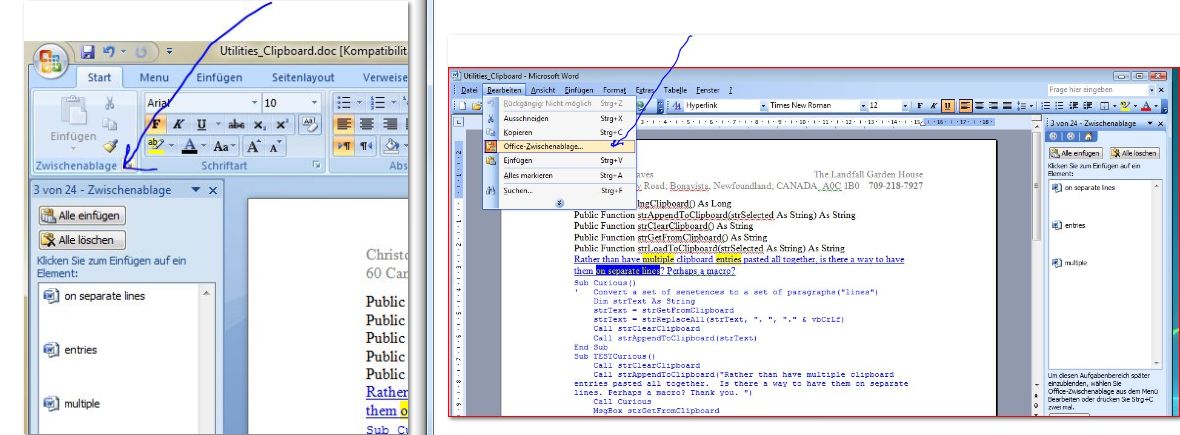

In the meantime we got a bit more insight into what The Windows Clipboard is really all about: It seems we are not strictly playing with a clipboard here, since there is only one, and that thing often referred to as the Office Clipboard aint really part of the The Windows Clipboard : What we are doing here is messing with something that makes its own limited copies of things last set to go on The Windows Clipboard , (in many cases, especially in Excel, those things never get there, ( there in the real clipboard that is) until a Paste. )
We are messing with something that could also be described as a specific viewer of the phenomena that is The Windows Clipboard
Also if you have multiple versions of Office open, they will all make their own independent copy of what is sent or set to be sent to the windows clipboard, but all our coding attempts so far will just clear stuff in the version its running in. That last bit is perhaps an important point that might be worth saying again a bit differently: Say I have Excel open from Office 2003, and I have word open from Office 2007. I then go somewhere, (anywhere, does not have to be anywhere in particular other than in Windows ), and I copy a word, Alan. That now appears in two list, one in each of the open Office versions: https://i.postimg.cc/nrhXLb56/A-Clip...ce-version.jpg
But if I use just one of the two Clear All Buttons, then it only is cleared from that list. So that is telling us again that each of the two things is monitoring and making its own copy of what is going or set to be going to The Windows Clipboard
(Some quirky contradiction like things do exist however. For example after using either Clear All button in one of the Offices, you will then no longer be able to do a simple windows Paste operation, even if things were copied from , and are still showing in the list in the other Office. So somehow either button does have the side effect of clearing the windows clipboard)
So there is no single Office Clipboard in the way that there is a single windows clipboard.
I am not trying to be annoyingly pedantic, - I just think it helps to understand things a bit better, which might lead to better and more interesting and clear solutions . Maybe calling it an Office’s Clipboard monitor might be better.
A confusing quirk is that messing with it might effect the thing its monitoring. Maybe a bit like a old analogue pressure meter measuring some very high pressure large gas tank, and because of some badly designed leaking spaghetti dependency chains, if you mess with the monitor you might cause the tank to explode!
