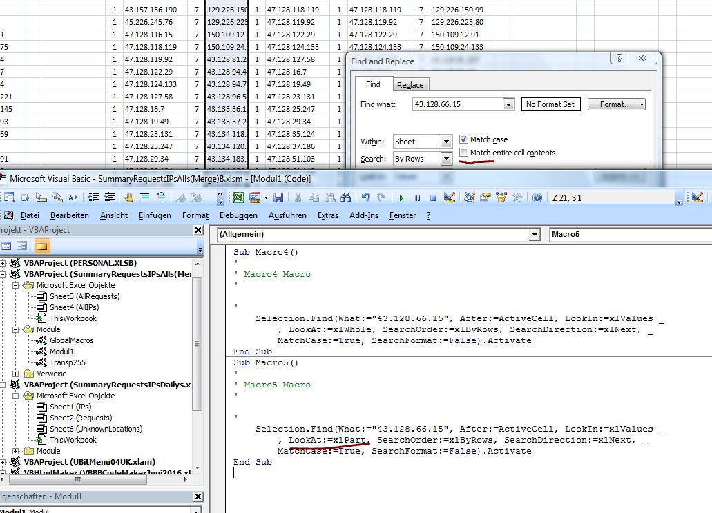

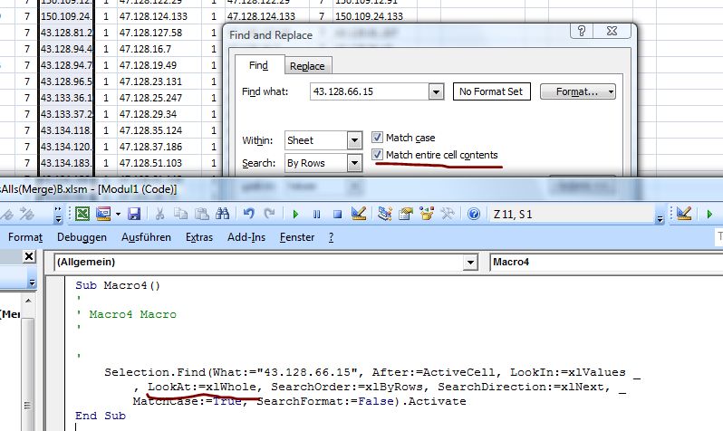

Actually that is not a problem, what is a problem is that I was stupidly doing LookAt:=xlWhole whish is Match entire cell contents whereas I should have been doing LookAt:=xlPart : In the coding , the thing I am looking for is the stripped down number, thus
Dim Wot As String
Let Wot = Replace(wsAllIPs.Cells(Cnt, NxtClm + 1).Value2, vbTab, "", 1, -1, vbBinaryCompare)
Let Wot = Replace(Wot, vbCr & vbLf, "", 1, -1, vbBinaryCompare)
Let Wot = Trim(Wot)
Set rngFnd = rngSrch.Find(What:=Wot, After:=wsAllIPs.Cells(Cnt + 1, NxtClm + 1), LookIn:=xlValues, LookAt:=xlWhole, SearchOrder:=xlByRows, SearchDirection:=xlNext, MatchCase:=True)
Do While Not rngFnd Is Nothing
Let wsAllIPs.Cells(Cnt, NxtClm) = wsAllIPs.Cells(Cnt, NxtClm) + rngFnd.Offset(0, -1).Value ' Hits
rngFnd.Offset(0, -1).Resize(1, 2).Delete Shift:=xlUp ' Delete duplicate row after adding hits and ip addresses
So I will not catch any numbers in the list with something like a vbTab tacked on it. So I fucked up.

Here is the 6 results
$A$1
$A$1
$A$1
$A$1
So, I probably want to start again, and do both the new coding idea ( ___b)(i) ) and correct the Sub SingleIPList() , and while I am at it, do a Sub SingleIPListDics() , as there is since Xmas 2025 a lot of high view counts to consider.
