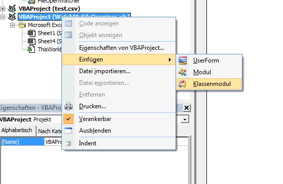

I started with a new virgin simple .xls file, and put a Class Module in it

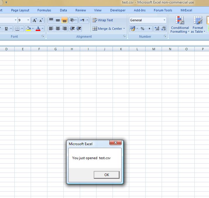

(By the way, What actually happens (should happen) is that …
Provided you first open the main file with all the class stuff in it, ( that was your (OP SamPi) OpenExcelFile.xlsm , and it is now my WatchMyFileOpenings.xls), then after that , if you open a file with the name test.csv , then, a message box should pop up and tell you about it )

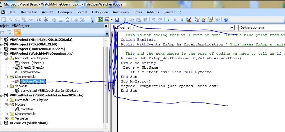

First the Class module stuff.
This is my slightly modified version of your (OP SamPi) coding put inside the Class module.
I gave the class module the name FileOpenWatcher , but that does not mean much. Initially, before we put text of coding into it, its just like a blank sheet of paper.
Finally as below, it’s not much more. It is just like text on a bit of paper. Whilst not completely incorrect, it might be dangerous to envisage this as a template. This might cause one to think of it as a thing to be copied and used over and over again. Later with hindsight, this conception can be misleading. It is better to think of it as some notes in your pocket on a piece of paper, that you work from to make something over and over again. Think of there being other text notes and information, which we personally do not concern ourselves with, and when we use all the information, the text of the coding is just one thing we use. Generally it is a bad idea to consider copying of a class or coding in a class module. It can be misleading to the actual underlying concepts.

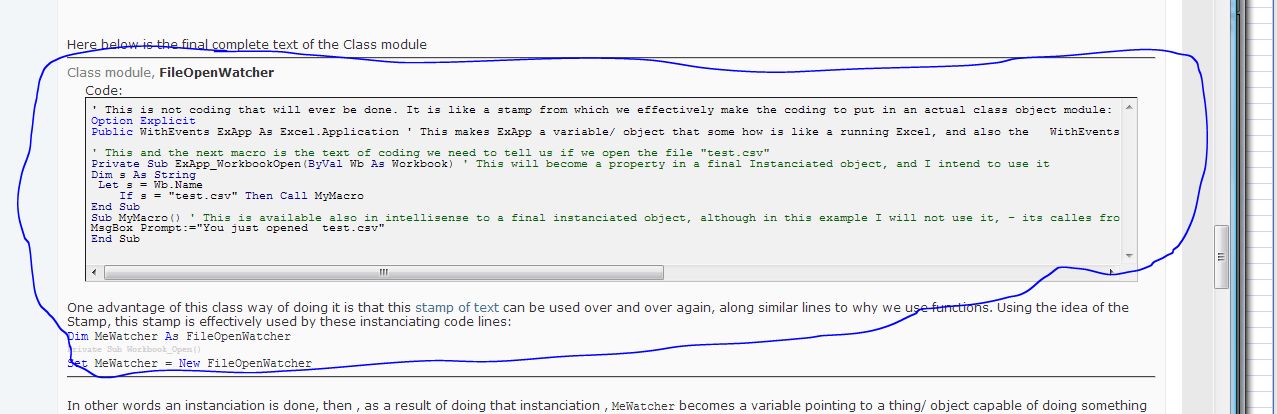

The class module is generally designed to be used over and over again, in the similar way that a function is. In this example we only use it once. Here is the full text. Perhaps that text could be thought better conceptually as like that on a Stamp
Class module, FileOpenWatcher: ( https://i.postimg.cc/TPPmLX2K/File-O...ode-module.jpg ) of WatchMyFileOpenings.xls
https://i.postimg.cc/4KMkxb6y/Class-...en-Watcher.jpgCode:' This is not coding that will ever be done. It is like a stamp from which we effectively make the coding to put in an actual class object module: This is a Class module. Not an actual class object module
Public WithEvents ExApp As Excel.Application ' This makes ExApp a variable/ object that some how is like a running Excel, and also the WithEvents means it has access to all those codings that it has that kick off when something happens

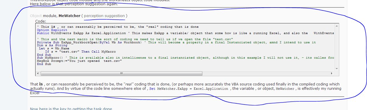

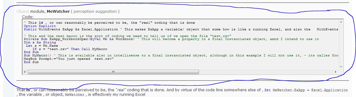

That coding is not actual coding that will ever be done. It is like a blue print, or a Stamp , from which an actual object module will be made with that coding in it, (by an instanciate later in coding in another code module –
In other words, something looking just like that, could be considered to appear, Stamped out as it were, by executing the following code lines
Dim MeWatcher As FileOpenWatcher

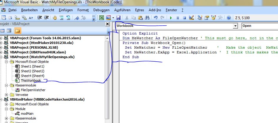

Private Sub Workbook_Open() ' This is done when this file opens
Set MeWatcher = New We must image this appearing, as we do not see it)
The full coding(text) window shown above is in a true Class module, as I tried to explain in my previous post , so its just like text on a piece of paper, and on its own pretty useless.
Lets explain the build up of that text (which will later be coding):

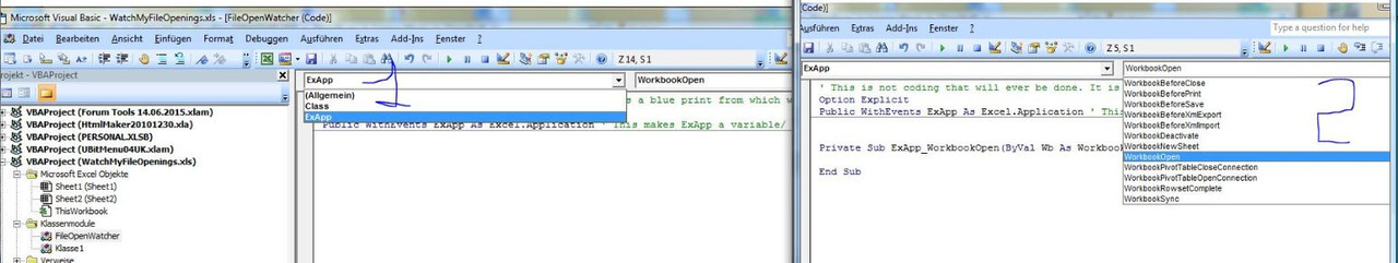

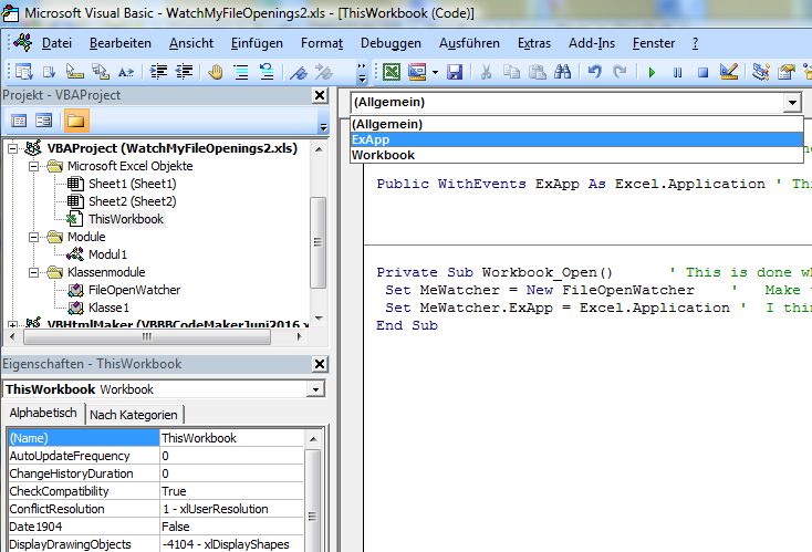

The very first line, Public WithEvents ExApp As Excel.Application , does something along the lines of making the variable, ExApp ,somehow be of a type like the Excel you are using, but not specifically the actual one you are using.

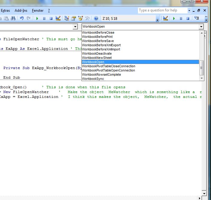

The extra WithEvents means it gets all the usual Excel event codings so we can tap into them, ( and for convenience, after you make this line we get them extra things listed in the drop down list of the Class module
Attachment 5836
https://i.postimg.cc/KzKv0fGL/Drop-d...ith-Events.jpg
We have chosen the event coding that kicks in when a workbook is opened, as that is what we need for our particular example
As generally with event coding, it can be considered that it is always there and runs when the event occurs ( the event of opening of a workbook in this example ), but we can add coding into it, so that this added coding also kicks in when the event occurs ( the event of opening of a workbook in this example )

So that’s it for the class module. It’s only half the full story. The second half is in the next post
A last important thing again to remember: This is just like a piece of paper with a text of coding on it that will never run itself.
We may "copy" that text and put it somewhere so as to use as "real" coding to be run.

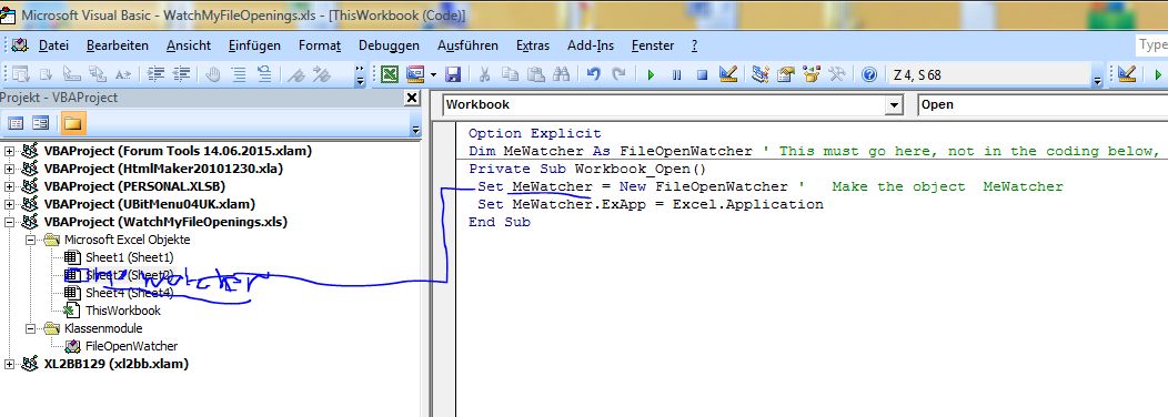

The "copy", is effectively done by these 2 sort of code lines later,
Set MeWatcher = New
