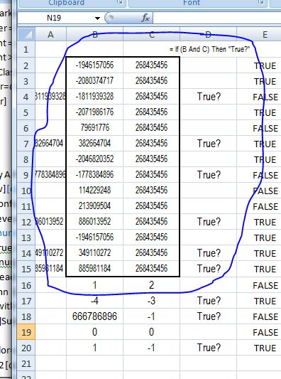

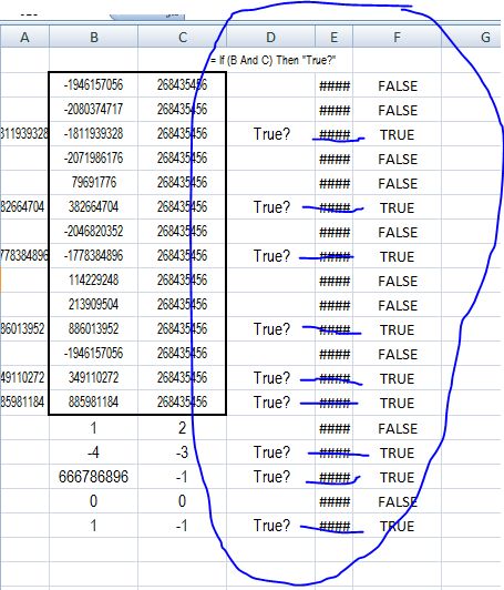

Conclusions, … Oh dear :(
I thought it was too good to be true. It did tons of tests, my coding is sound, and definitely does what I think it should with all data extremes
It doesn’t’ get the right bloody results though: ….Compare… as before, column D ( which effectively does what the main full codng does ) which gets the correct results.
Based on everything so far, this is the test coding to get results in column E
Sub TryMyFuncsNumberInBinaryNumbersInVBAIf_And_Then()
Range("E2:E20").Clear
Dim Rw As Long, arrRws() As Variant: Let arrRws() = Range("A1:C20").Value
For Rw = 2 To 20
Let Range("E" & Rw) = NumbersInVBAIf_And_Then(arrRws(Rw, 2), arrRws(Rw, 3))
Next Rw
The results, however, speak for themselves..
https://i.postimg.cc/2jxYmcbH/Bollox.jpg
Attachment 6120 https://i.postimg.cc/2jxYmcbH/Bollox.jpg
Bollox
