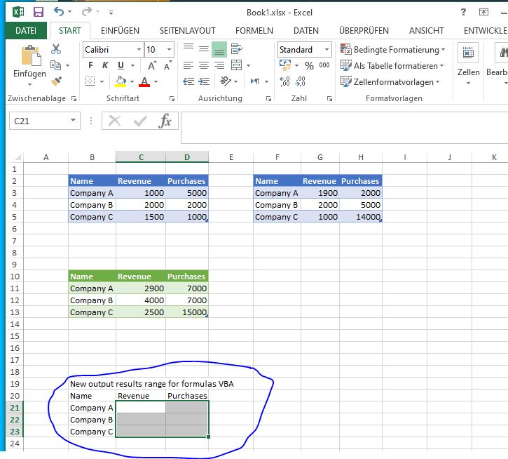

As sandy666 has given a solution with an example file, I will do a short VBA / formula solution example as a comparison using similar data.
But I will put the results in a new output range so as not to disturb or destroy that existing Power Query solution.
This/these is/are an example of a formula and VBA solution.

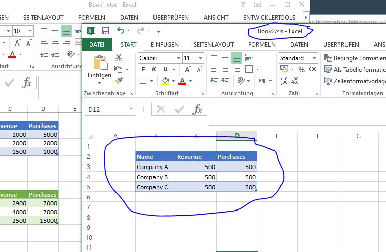

I think it helps with this demonstration to include another sample data rage which I will include in a separate new workbook, Book2.xls . For the demonstration solution to work, you will need to download both workbooks, Book1.xlsx and Book2.xls to the same place , (but a final solution does not have to have this restriction: Files can be anywhere as long as you know where.
Note that it is only necessary to have Book1.xlsx open for these demonstrations to work. The other workbook, Book2.xls , can be open or closed. This is because I am applying a closed workbook reference to retrieve values from a closed workbook, which is possible in Excel without VBA. (I am creating the closed workbook formula for convenience with VBA, but it is not necessary: you can add those formulas manually).
So, this first solution, Sub FormulaInWithVBA(), puts the same relative reference formula across the output results range, then saves the file.
Sub FormulaInWithVBA() ' https://www.excelfox.com/forum/showthread.php/2991-consolidate-identical-reports
' Let Workbooks("Book1.xlsx").Worksheets("Sheet1").Range("C21:D23") = "=SUM(C3,G3,'C:\Users\acer\Desktop\[Book2.xls]Tabelle1'!C3)"
Let Workbooks("Book1.xlsx").Worksheets("Sheet1").Range("C21:D23") = "=SUM(C3,G3,'" & ThisWorkbook.Path & "\[Book2.xls]Tabelle1'!C3)"
Workbooks("Book1.xlsx").Save
Finally you have a formula solution, as you only are using the coding once to put the formulas in: You could do the same by writing the formulas in yourself manually instead
The second solution, Sub VBA_ClosedWorkbookFormulaSolution() , is almost the same, but it simply converts the formulas to values.
Sub VBA_ClosedWorkbookFormulaSolution() ' https://www.excelfox.com/forum/showthread.php/2991-consolidate-identical-reports
Let Workbooks("Book1.xlsx").Worksheets("Sheet1").Range("C21:D23") = Workbooks("Book1.xlsx").Worksheets("Sheet1").Range("C21:D23").Value
