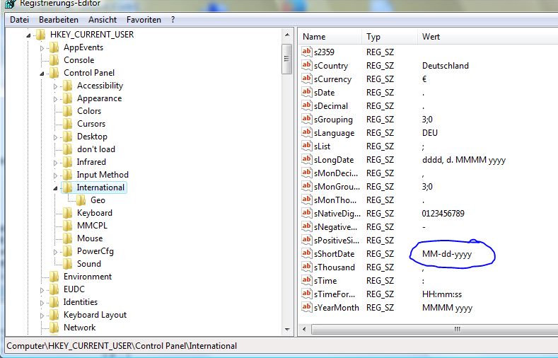

Rem 1 sShortDate ( https://i.postimg.cc/x8mr56rZ/System...ate-format.jpg https://i.postimg.cc/bYSjqwGR/System...ate-format.jpg )

System short date , sShortDate
Possibly by design, or possibly by accident due to the last point, you will always get returned by a macro recording the code line like .._
.NumberFormat = "m/d/yyyy"
-… regardless of what your specified system short date is.
This suggests that .NumberFormat = "m/d/yyyy" is really saying/ meaning use system short date format. The results you get partially support this. But not fully: once again you may gat inconsistent results using it.
