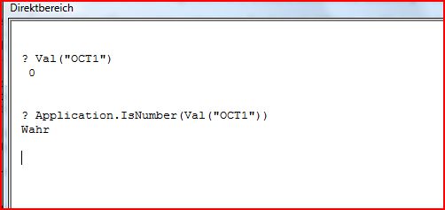

Application.IsNumber( ) is an alternative to IsNumeric( ))
Thanks for these ideas, Rick. - I just thought I would mention that, as I passed this Blog post on just now, I saw in that Thread something that might be worth mentioning here in passing, which is that Hans offered an Excel Worksheet function alternative, Application.IsNumber( ) , which seems more likely to give results closer to what most people would expect.
If I understand correctly the main difference between the two functions can be thought of approximately as
IsNumeric( ) is True if it thinks it can convert the given text into a number, whereas
Application.IsNumber( ) is more likely to be True only if the passed thing looks like a number, ( it won't , for example . convert a text into a number, even anything simple like "2" )
That is just an approximate conclusion as I have not investigated thoroughly both functions yet…
The intelligence behind IsNumeric( ) is perhaps a different one to ours, and perhaps as a compromise for efficiency does not thoroughly check for correctness, but rather looks for some allowed characters that might be used in some number formats,
( and it allows a text that has a number format,
( whereas Application.IsNumber( ) doesn’t: For example Application.IsNumber("1") is false because "1" is text )
IsNumeric("1") is True)
( Edit P.S. I geuss you will need to be in Excel or else load the Excel library in order to use Application.IsNumber( ) )
